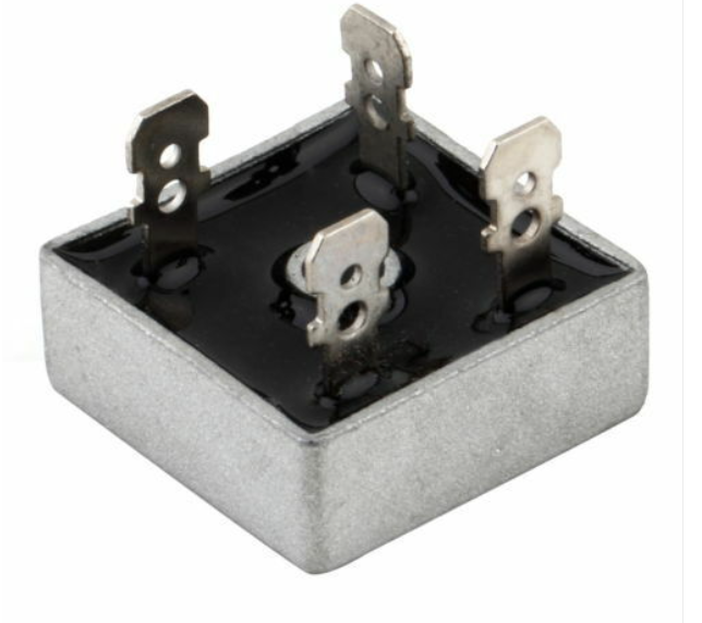

Hi, I'm new to the forum and would appreciate some advice regarding the above machine. Although this a very old machine it hasn't been used much but has alway had wire feed issues hence I converted to a Euro torch and Dinse type earth lead. However, the changes have not had the desired affect and the welder struggles on 1 mm mild steel on any of the 6 power settings, I have checked all connections for tightness and cleaned, where necessary, but the lack of power/penetration persists. I have taken the following AC voltage readings from the rectifier posts and these are between 43.1 - 50.8 on Range1 setting and 55.9 - 69.5 on Range 2. The DC readings were taken after the rectifier and attached to the power lead that attaches to the torch from the rectifier and the earth connection was where it meets the choke, these ranged from 18.9 - 23.0 on Range 1 and 25.5 - 32.9 on Range 2. Do these voltages same correct or are they deficient , any help would be much appreciated .
