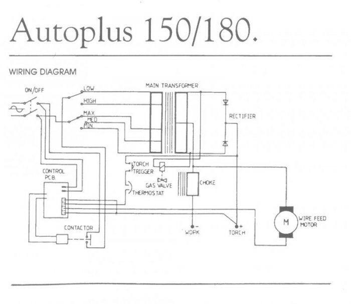

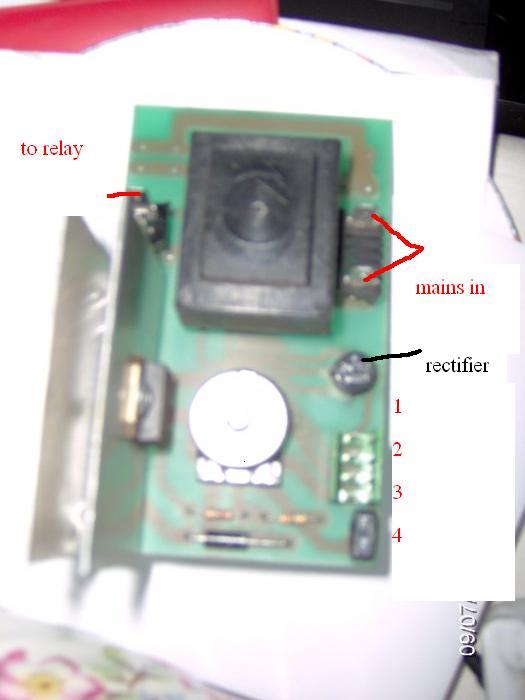

Hi, all
i had a friend call on me this evening he asked me
about my welder so we got talking and he asked me
when did i change it to euro torch.
i replied i havent he said it used to have the other type
so on closer inspection you can see where wires have been
cut so i think it has been wired wrong.
so has anybody on the forum have the same welder
i know i am asking a lot would you mined taken the
side panle off and take a couple of photos so i can rewire
mine please.
or a good wire diagram
thing are desparate as my daughter whants her car on
the road
plus i can get my car back
PLEASE HEEEEEEEELP
