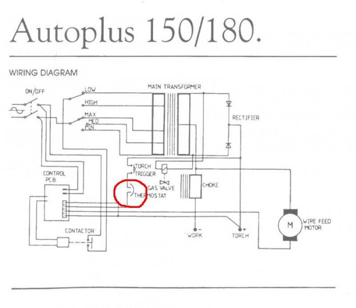

I have a SIP AUTO PLUS 180 the problem i have is when trigger of gun
is pressed nothing happens so i bought a new euro tourch and the same
nothing happens.
so i have taken the side panel off and i have found a switch like thing
in a plastic see threw holder with contact points
so i have taken it out of its holder and touch the points together
and it works.
has anybody any idea what the cause is or if there is a way i can
bypass this switch with the contact points.
or where i can get a wire diagram.
