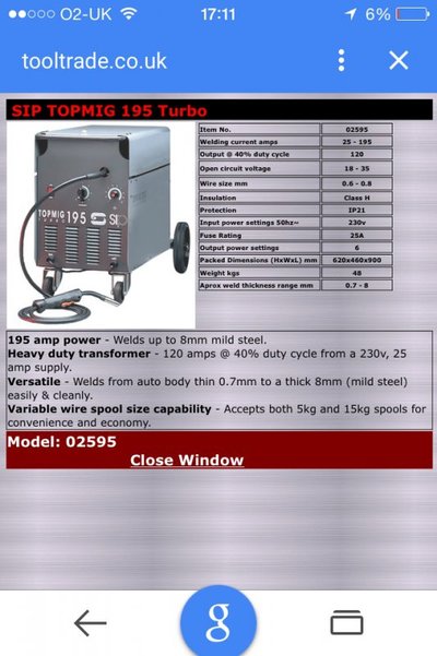

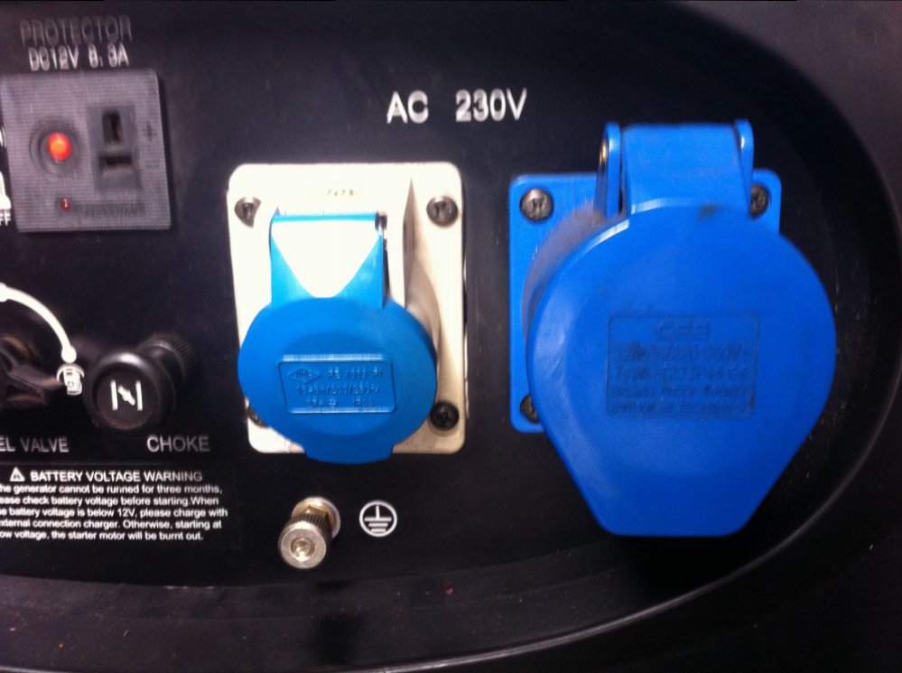

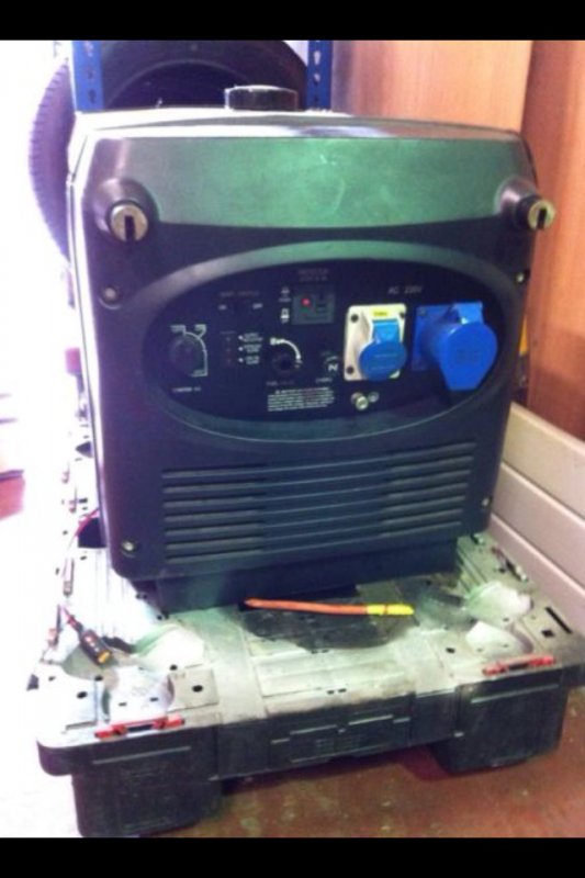

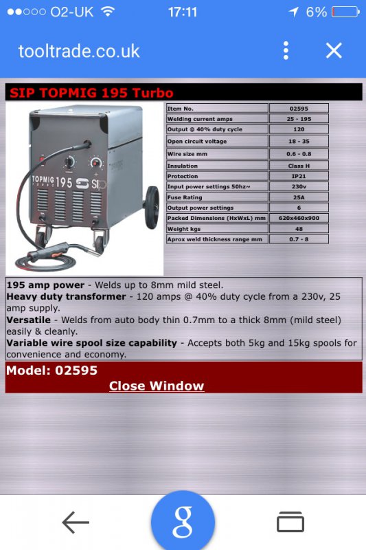

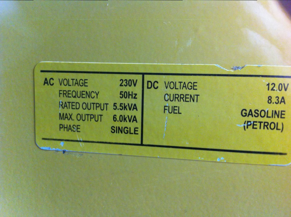

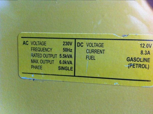

Well had it running today and didn't let me down , apart from bit drag on wire set did fine , no undercut and pooled in nicely , only couple times burnt through where plate was thinYou'll be alright on 3mm, just make sure the air filter is clean on the genny, they loose lots of power if the air filter is clogged, same goes for the fuel filter if it's got one.
