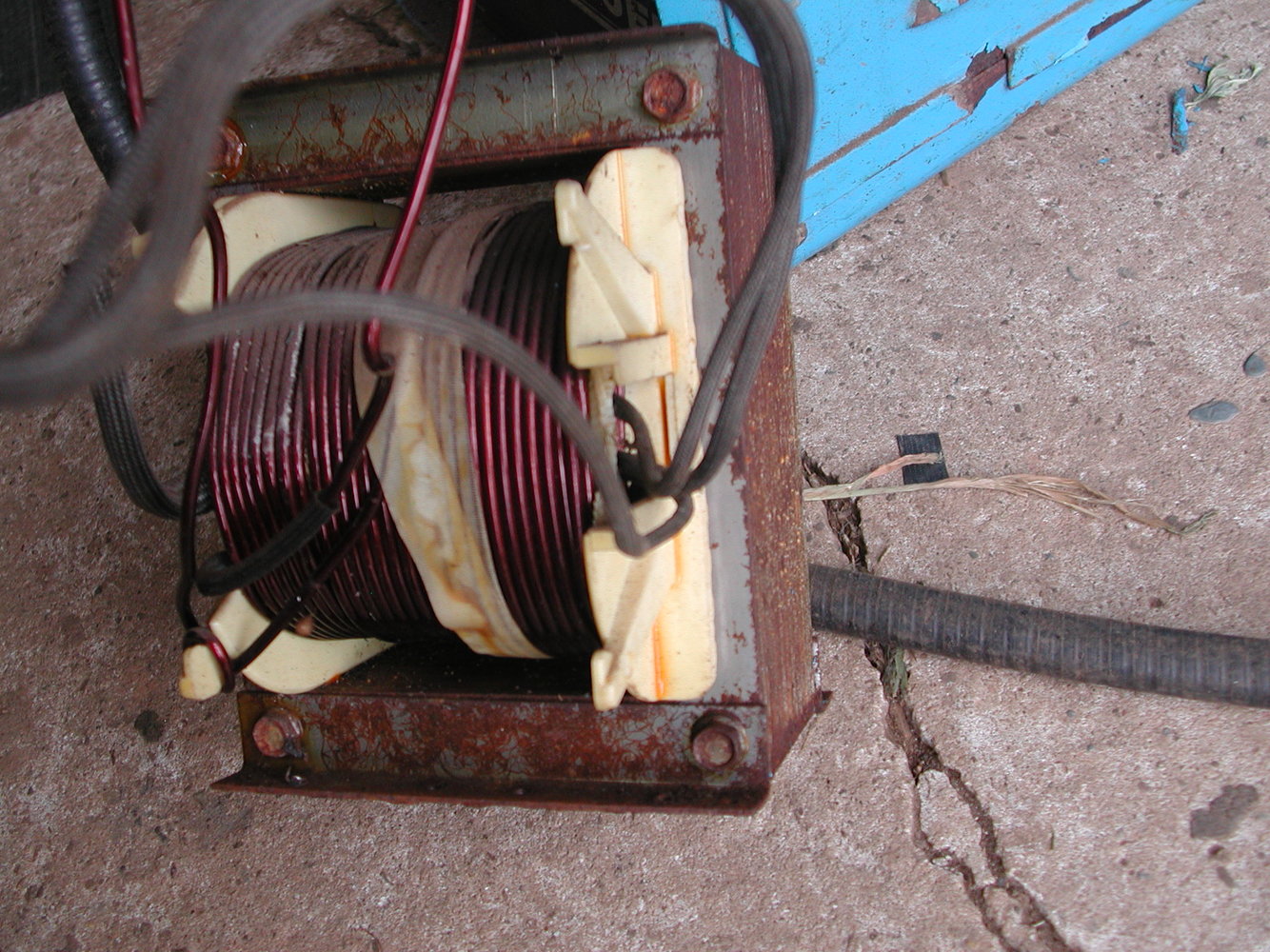

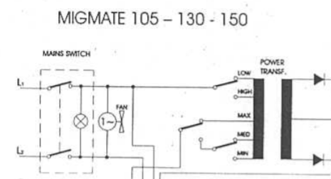

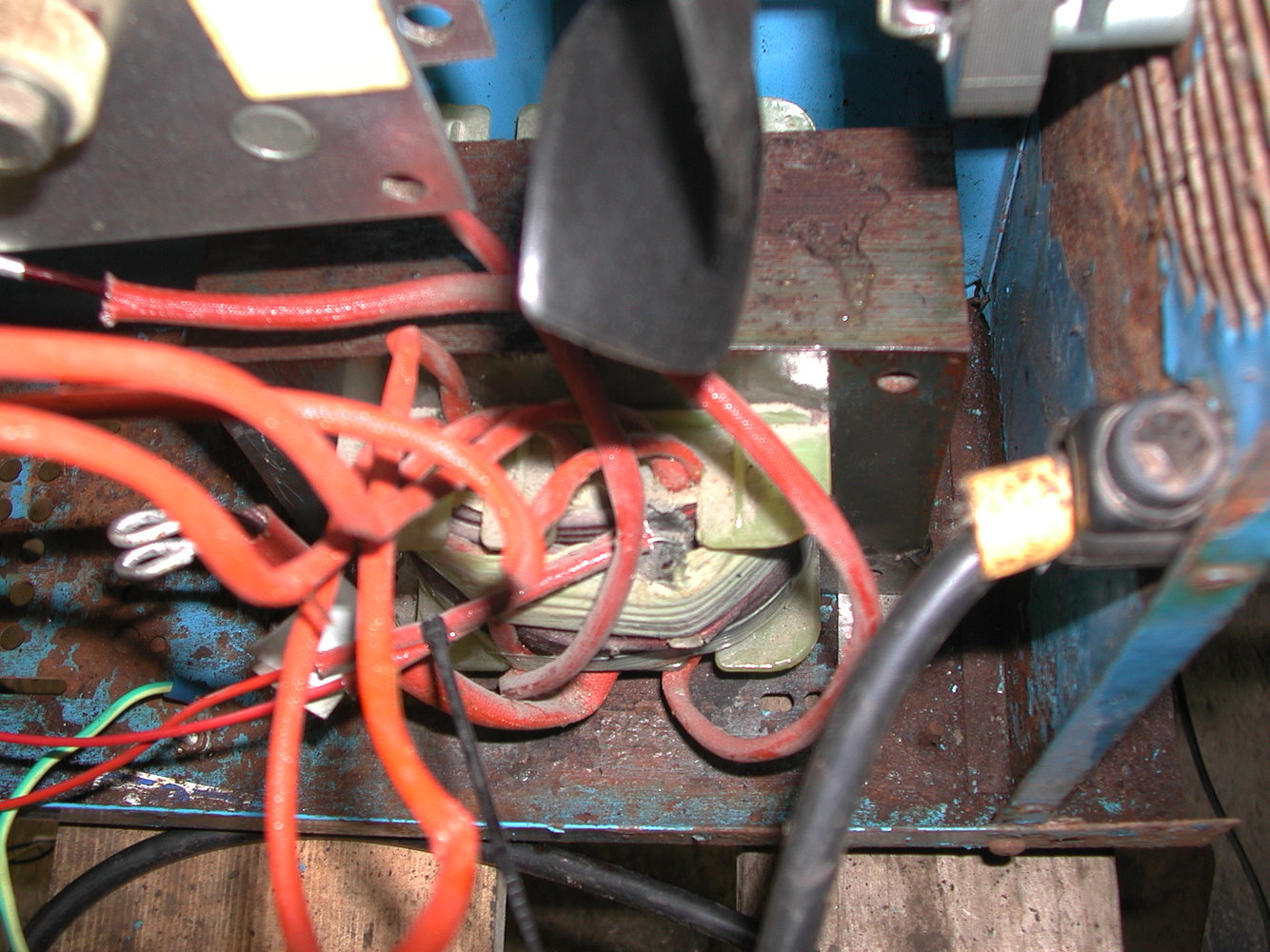

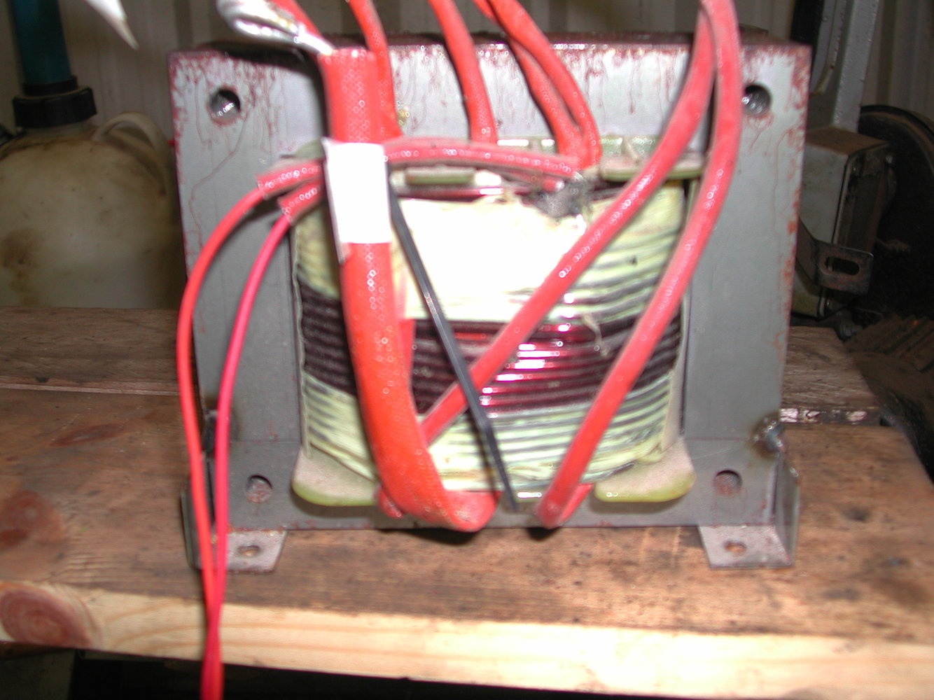

I think you may be right about the two wires, one is connected to some sort of temp switch.One explanation for the two light-duty wires is that they go to a temperature sensor inside the transformer coil. If this is the case, there would normally be zero Ohms resistance between those two wires.
