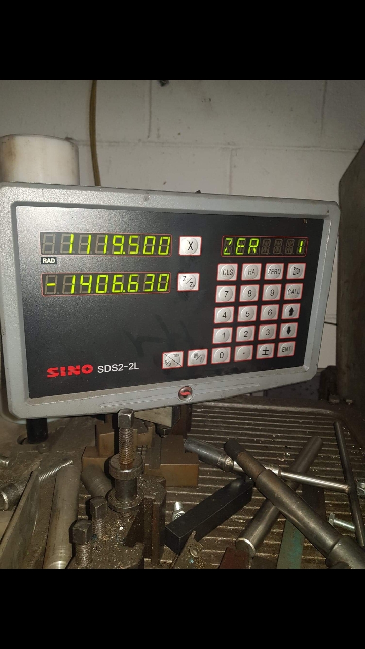

The buttons look very different to my Sino DRO (mine has X0, Y0 and Z0 buttons as well as X, Y and Z). Has your friend tried pressing "X", "0", "ENT"? That would work on mine to set zero (as an alternative to pressing X0).Hi- can anyone help with a Sino dro question.
This isn't mine but a friends. He cannot get each axis to zero. The values increase / decrease so not an issue with scales. Pressing zero does nothing.
Any ideas?
Will try and report back.
I'd also be tempted to try the "CLS" button.
