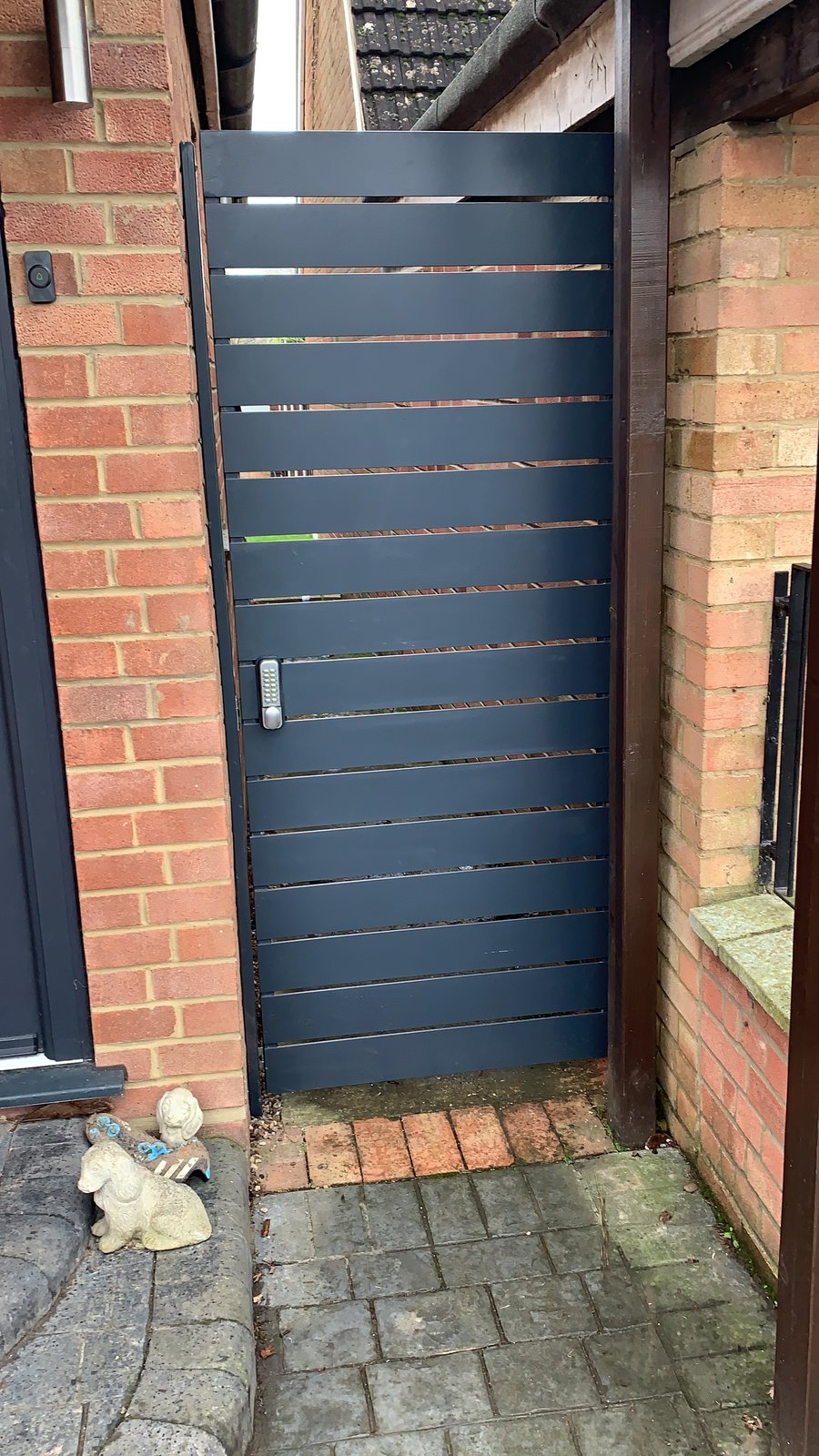

danbrown89 Member Messages 223 Location Watford Nov 17, 2019 #1 Gate frame was made from 50x30 RHS 100x5 flat on the front with 10mm gap Side posts 50x30 Digital combi lock from Toolstation zinc sprayed + 7016 F349F188-B7D9-44E0-9F63-2E163C717CE2.jpeg 325.4 KB · Views: 110

atomant48 Member Messages 1,811 Location Salisbury, UK Nov 17, 2019 #2 Reqlly like that. Would match my garage door perfectly. Any more pics of the build ? Are the slats pretty firm ?

C Climber Member Messages 587 Location Wiltshire Nov 17, 2019 #3 Have you got a pic from the other side?
danbrown89 Member Messages 223 Location Watford Nov 18, 2019 #4 Will take a picture from inside when I get the chance. The gate is solid, to be honest a little too heavy! Couldn’t lift myself and I’m the strongest geezer in Watford.... when Anthony Joshua isn’t about
