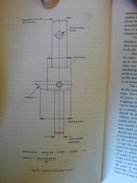

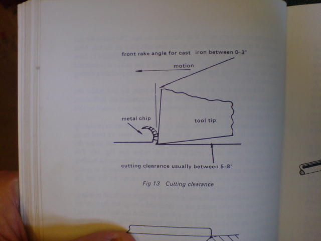

Hi,
I have a requirement to make a custom single point cutter holder to carry out some modifications on a cylinder head. The tool will be used to cut a recess around the outside of an intake / exhaust throat.
The largest throat will be around 31.7mm, the valves are 35.6mm so the tool would need to cut a recess between around 31.4 and 40mm

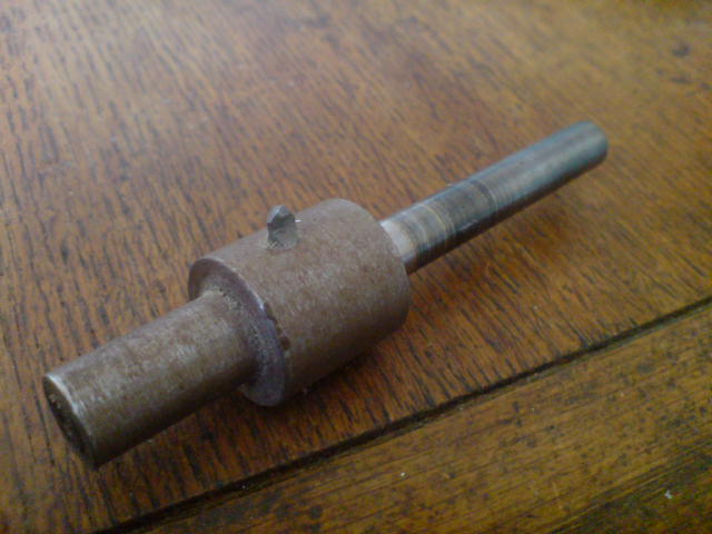

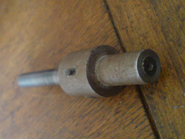

Here is one such tool:
In this picture it is in a mill but at a push can be used in a pillar drill for small jobs and I am in need of the latter.
Could anyone help point me in the right direction?
