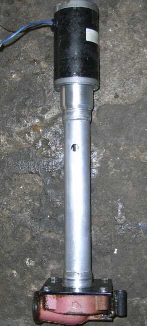

Grabbed an old heating pump that was being chucked last year. But the pump had to be in/below the suds to work so wasn't really suitable as I wanted to dunk it in an old detergent container of suds.
Eventually got round to extending the aramature and putting some distance between the pump and motor. It works a treat, I can shut the flow down to a proper trickle and it's dead reliable or turn it right and have loadsasuds.
