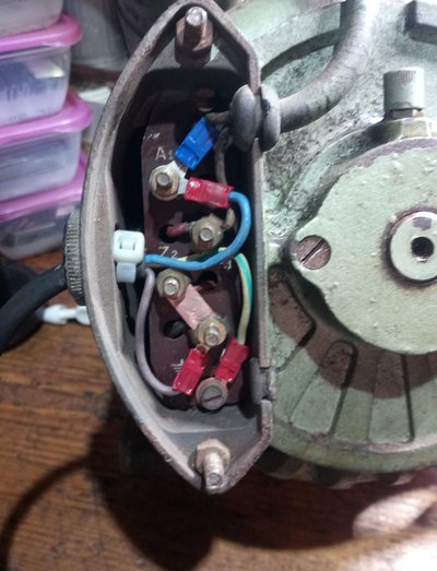

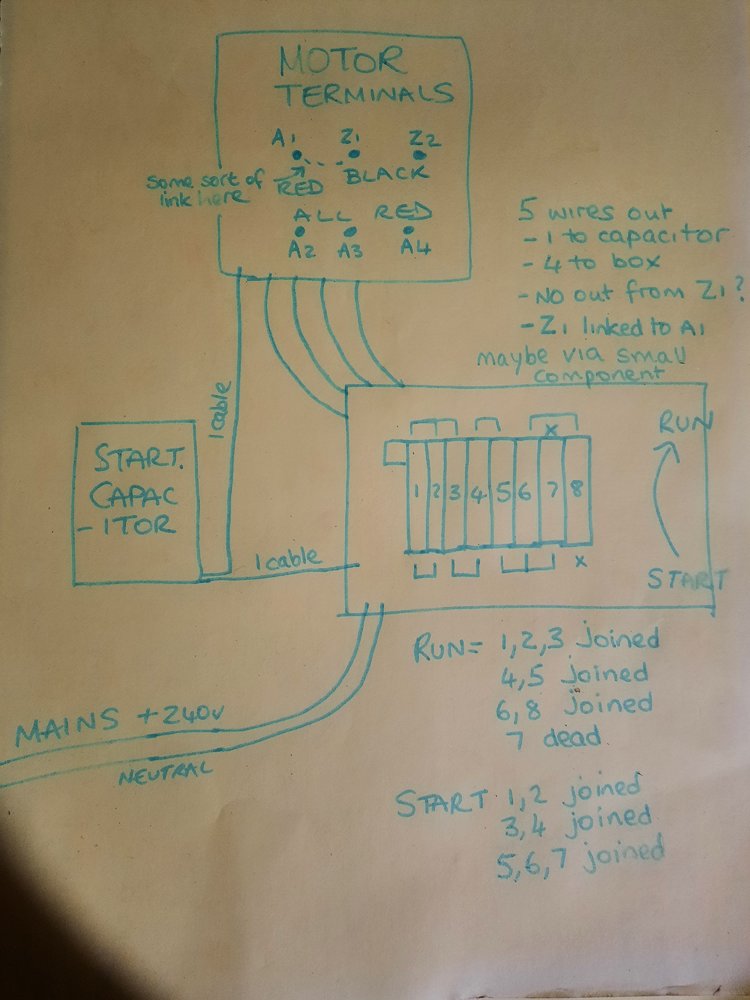

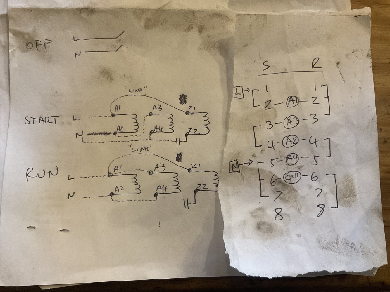

I’ve drawn what I think are the desired states in each switch position, assuming a series-start, parallel-run for the main winding A. The “Link” might be an NTC thermistor for inrush limitation to the start (Z) winding.
On the right, possible connections for the switch. I’m not sure about 7 and 8, but at least it has 4 wires to the motor and one to the cap, and corresponds with the two on states. Maybe the start cap/Z winding combo is somehow shorted in the run state, to discharge the cap.

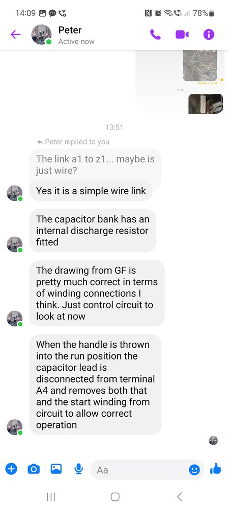

//Hi! See above reply to GF, maybe there is a wee thermistor bolted between a1 and z1? I did certainly read somewhere that some types of motor you just deprive cap of neutral, but i'm a layman.I concur with @Guineafowl and are likewise unsure about 6-7-8 in the run position. If this is for discharging the cap I'd expect to see a resistor to dissipate the stored energy rather than just a short.

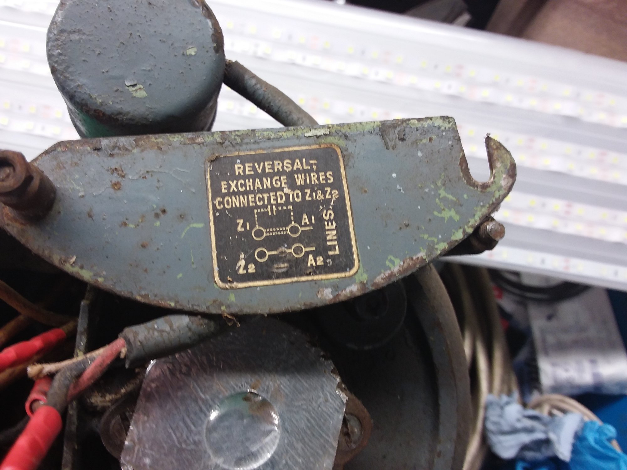

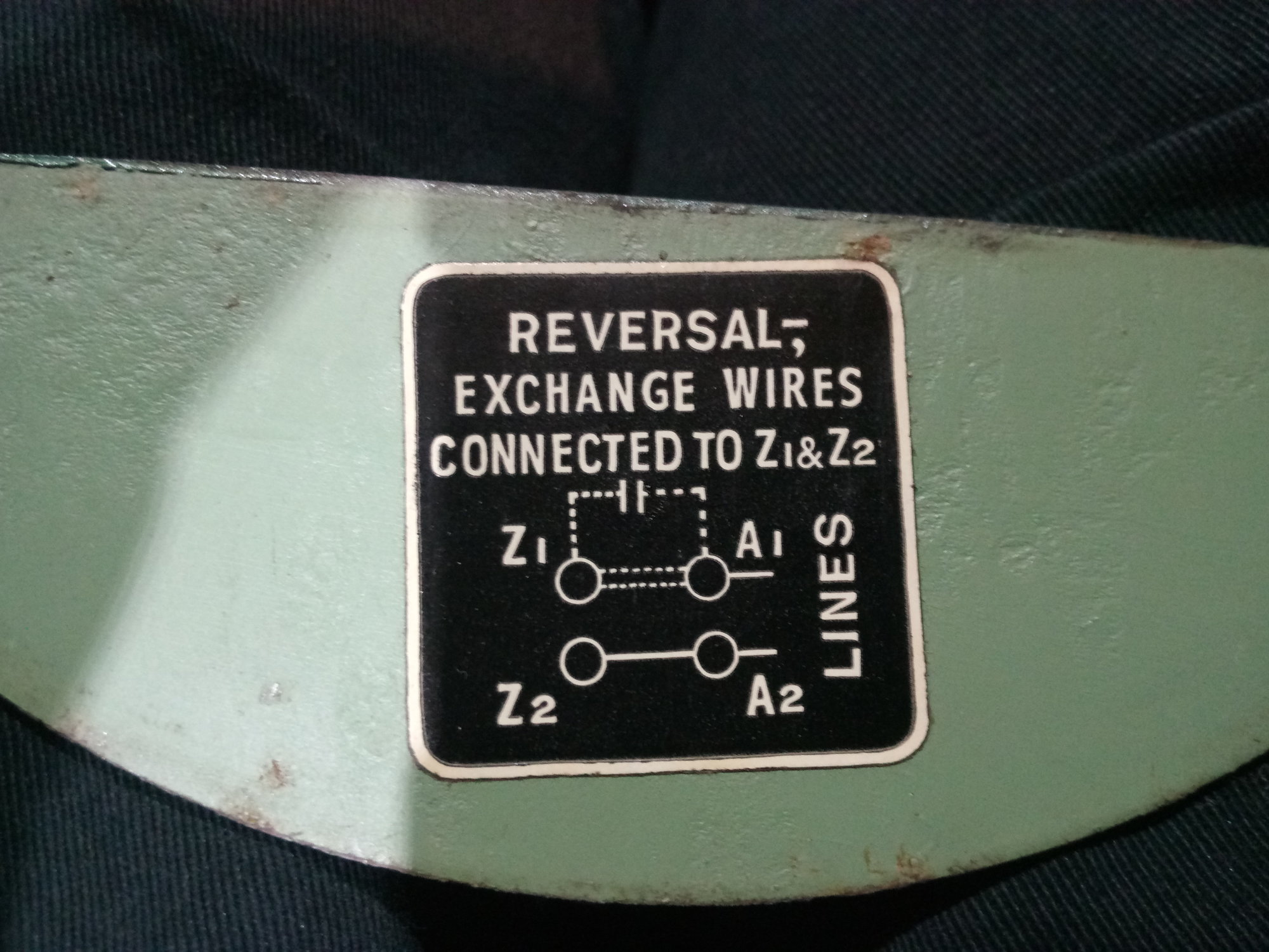

No need so far as I knowTo reverse direction (should you want to) reverse the connections to Z1 and Z2.

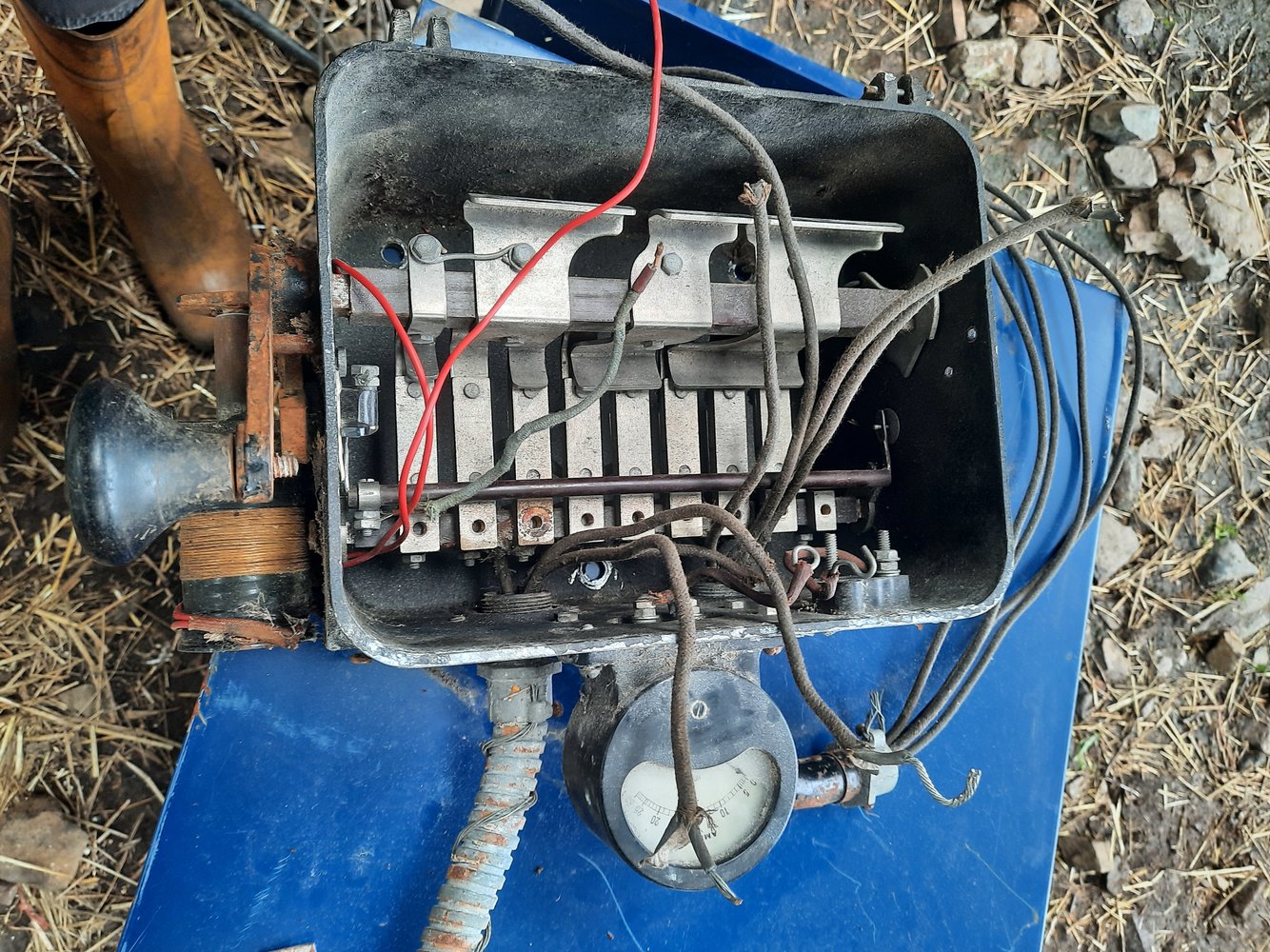

What so + to terminal 1 and - to t5? This would show a reading (perhaps of zero?) even when switch in off position? OR T2/T5 to prevent that?The ammeter would be in series with the supply input.

Sparky did soI'd also check the winding resistances to see A1 to A2 and A3 to A4 are about the same.
yeah? Haha.We're assuming that A1 and A3 are the starts of the windings so the magnetic field from both coils assists rather than cancels.
