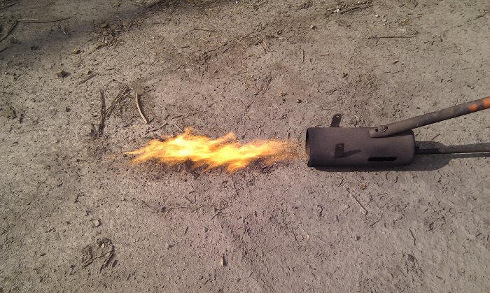

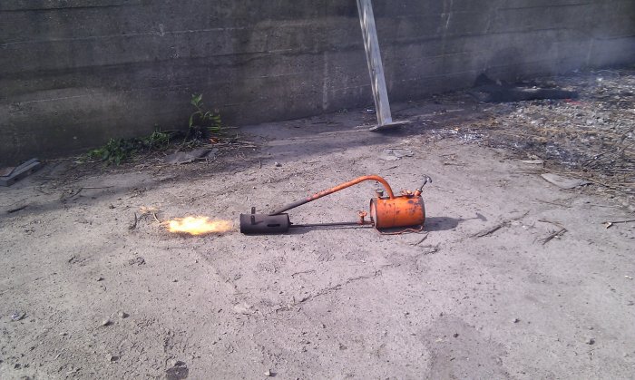

I dug mine out today but I reckon I might be better off with a combine harvester. Yours looks to be burning a bit yellow, the flame should be nearer a blue colour and roaring like a jet. Try removing the jet, square head on it just to make life difficult, but you can get the proper spanner and a pricker to clean the jet with quite cheaply. You will probably find debris in the end of the pipe, mine tends to block up on a regular basis, but when they're running right they are hard to beat.

I had mine running on red diesel rather than paraffin.
Am having a problem with the pressure pump to be honest.
It builds pressure up on the down stroke but when pulling back it creates a vacuum?
If i unscrew the pump and pump it that way it works fine when i pull the plunger all the way out.
If that makes sense.
