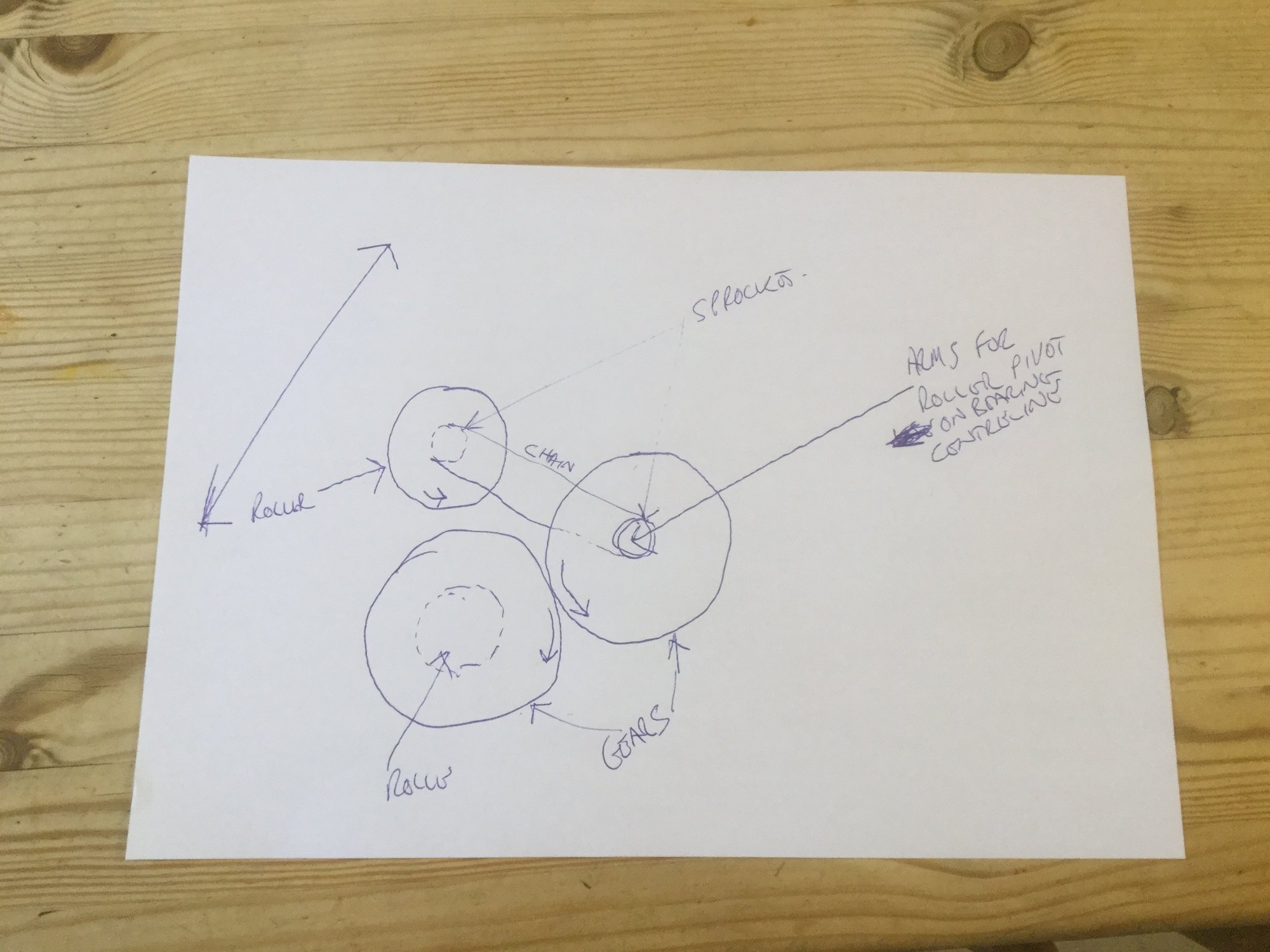

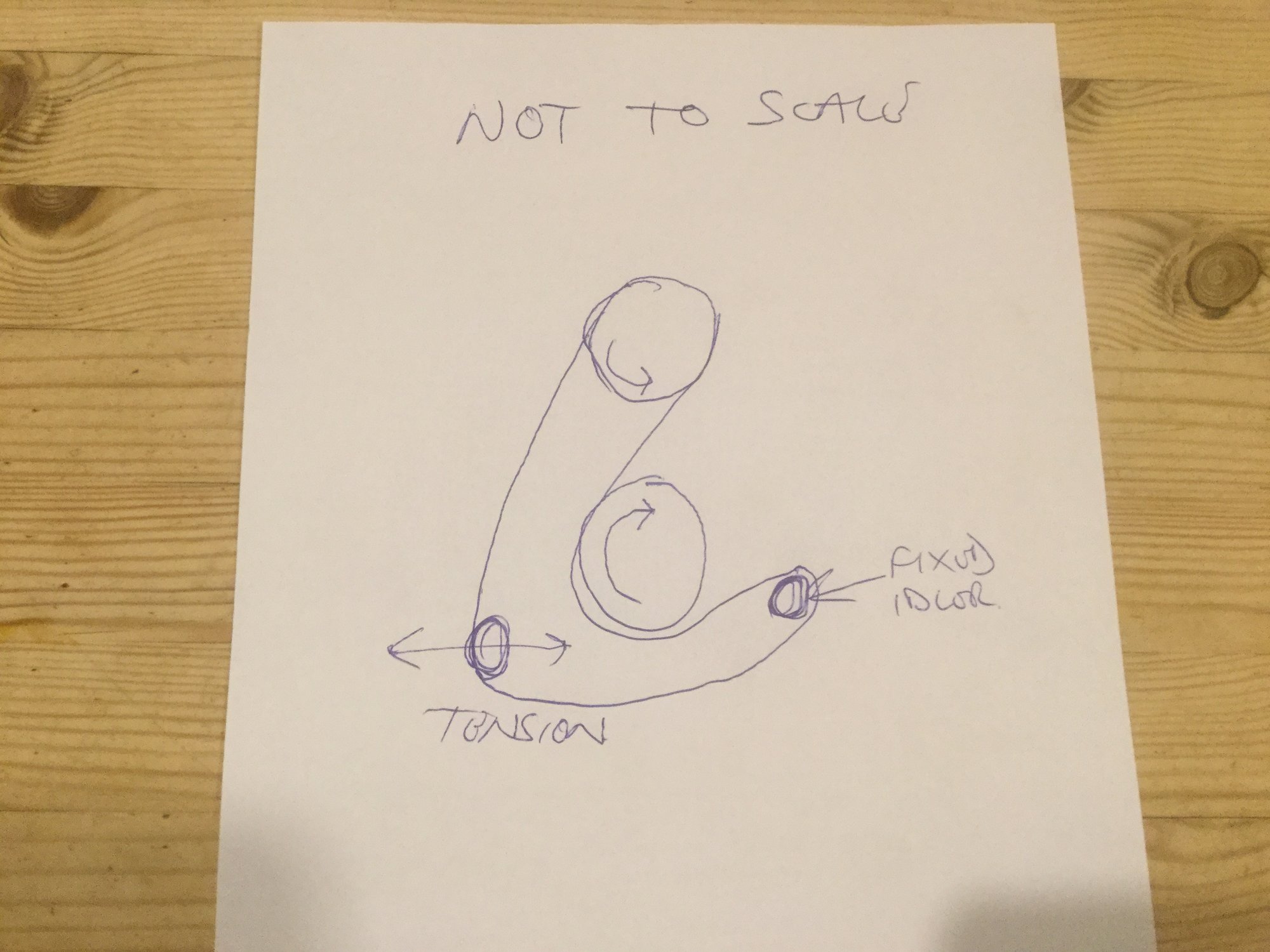

its a ready made, spring loaded, tensioning idler arm.
an easy way to make a rack/pinion would be to fasten the chain to the board - like the drive belt which moves the platten works on a 3d printer?
