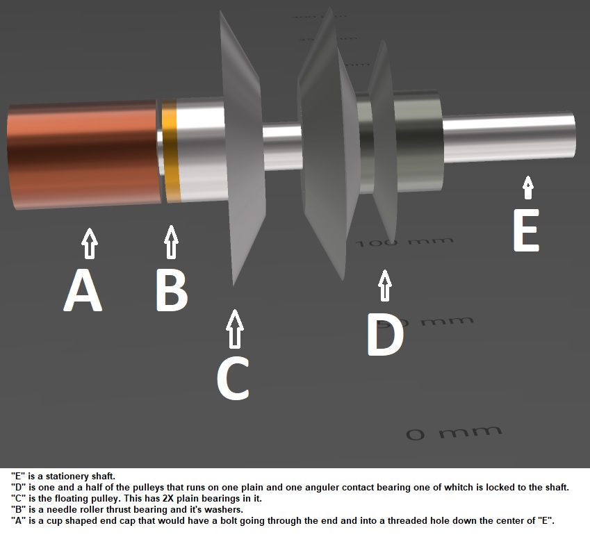

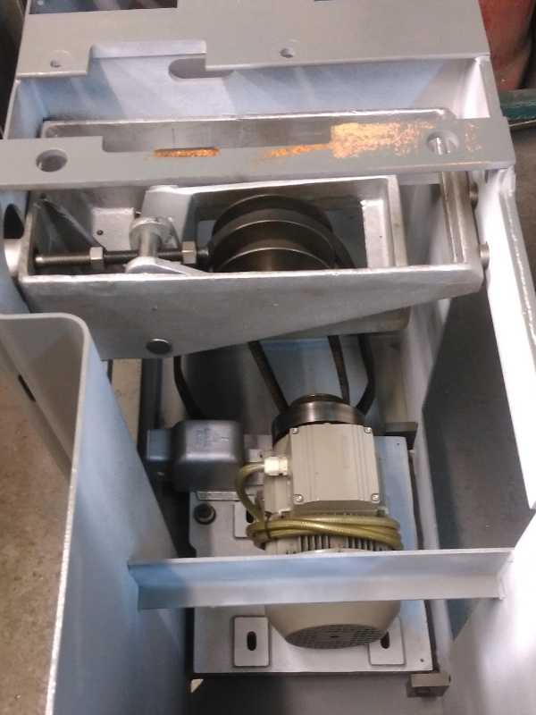

Are you running a single or 3 phase motor?. A 3 phase motor runs smoother than even a resiliant mount single phase, adding moving parts with clearance to the drive train definitely isn't going to make that better.
I've read on other forums there is a noticable difference in chatter/resonance/parting ability by just changing from single to 3 phase even without a vfd, I haven't been able to compare this myself though.
