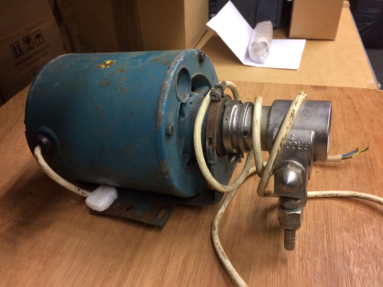

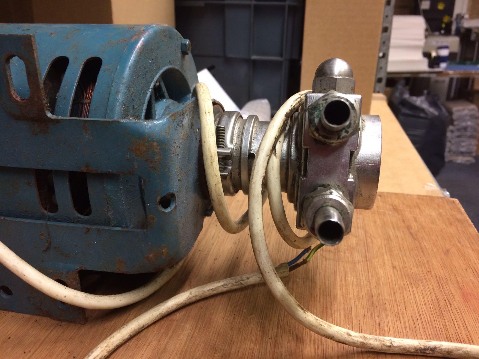

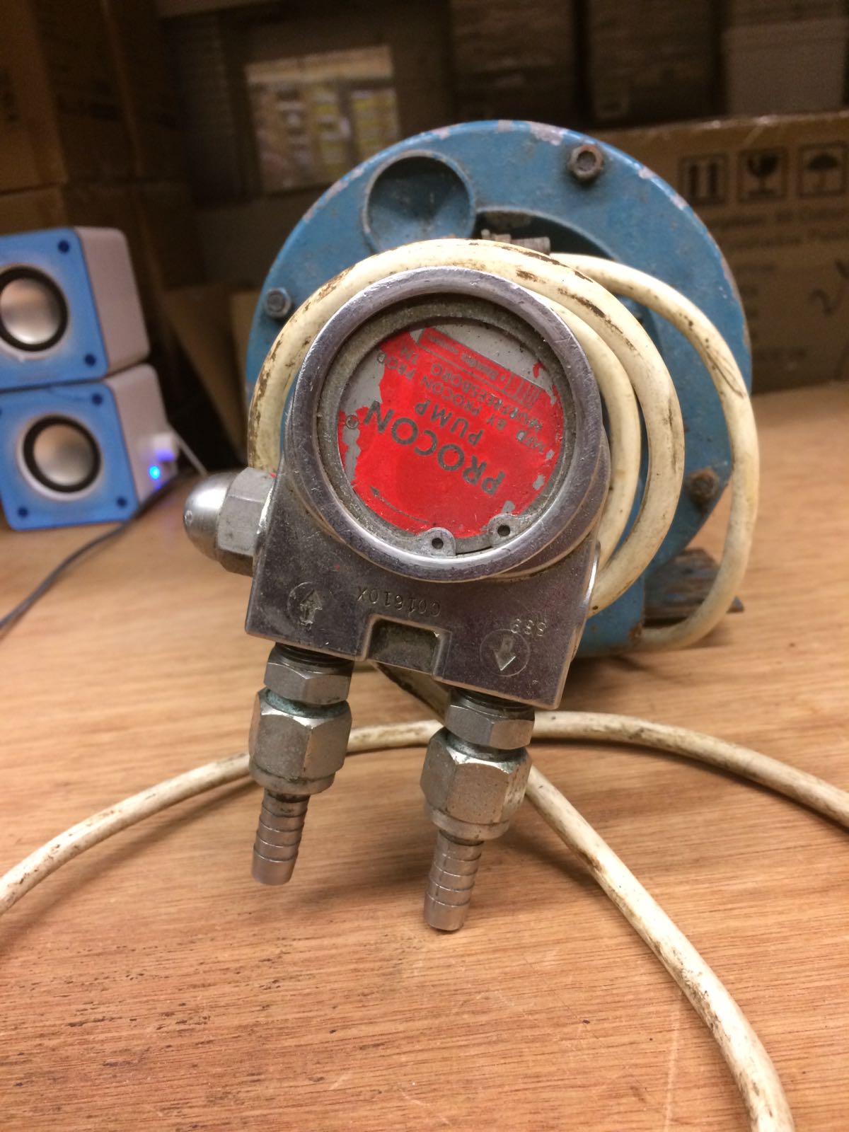

Although i'n new to TIG and not very good, i would like to get rid of the WP26 torch, Plus it got hot this morning running some beads at 90amps. So though i would make a simple cooler and get a water cooler torch.
Had a look at some other builds on here but cant get hold of most of the bits so will try to bodge something together from cheap bits i can find online.
This is what i'm thinking so far.
Pump 11.99 ebay.
PC coolant radiator
http://www.ebay.co.uk/itm/191832695517?_trksid=p2055119.m1438.l2649&ssPageName=STRK:MEBIDX:IT
Couple of PC fans.
Pc power supply.
Maybe
An ARDUINO with a couple of Temp sensors and flow meter.
No idea on the tank yet.
Can someone point me in the direction of the torch fittings please?
Pump 11.99 ebay.
PC coolant radiator
Couple of PC fans.
Pc power supply.
Maybe
, decided to buy an arduino and have been messing this evening. In theory as i can turn the led on and off i should be able to turn the pump on add off with an SSR, also bought some sensors which may arrive next year.
