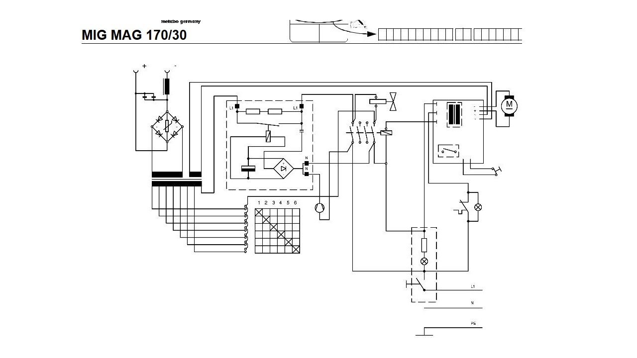

Hi

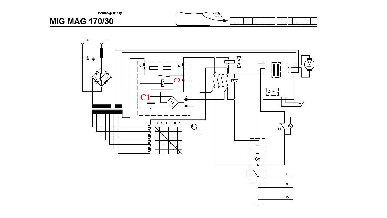

I want to assemble a (maximum) simple soft starter for a small semi-automatic welding machine, I saw that Electra Beckum (later Metabo) used one, but I don't know the capacitor values. Dashed frame in the diagram.
I know from experience that the starting resistors should be around 50-60ohm/10-20W, but what capacitors to get a switching time of around 1 second?
Regards!
