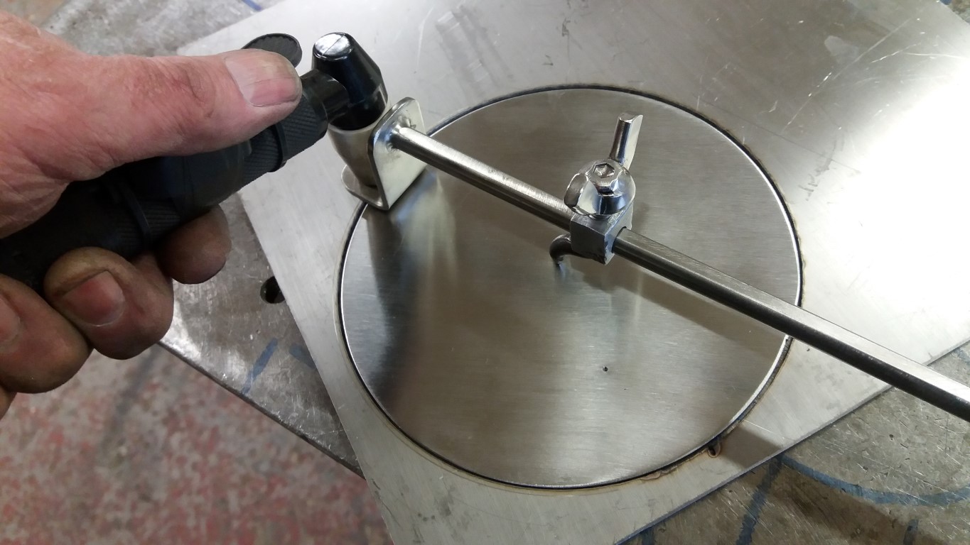

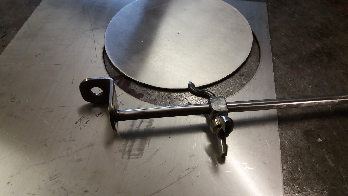

Been meaning to post this for a while, A simple to make circle cutter for the small plasma cutting torch with a drag tip. just knocked up from offcuts
Its a 2 handed job to use it, one on the torch and one on the centre to keep it in the centre dot, but very easy to use when you have done a few practice cuts.
