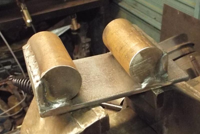

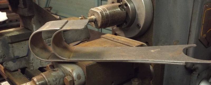

Some time ago I cut some brackets for angle grinders and although I could bend the units in a Machinemart bender, it was difficult to set up and get right when doing a 180 degree bend around a die.

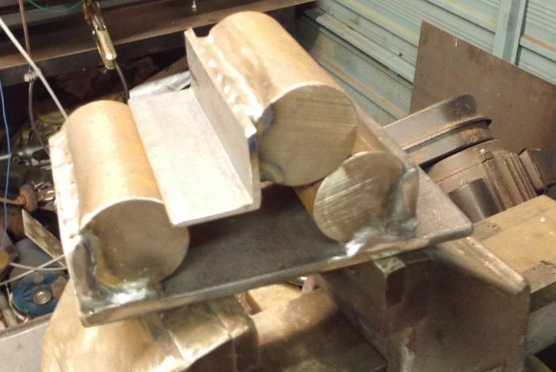

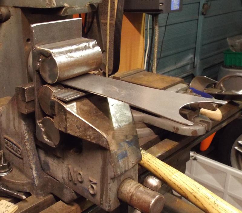

Had some bar and bits so made up a simple jig that will take up to 3mm thick bar, with the 2mm stuff I used today was very easy to do and then a little bit of rubber mallet to finish off, all done in the vice and seems very repeatable.
So well worth doing them for them small jobs.
