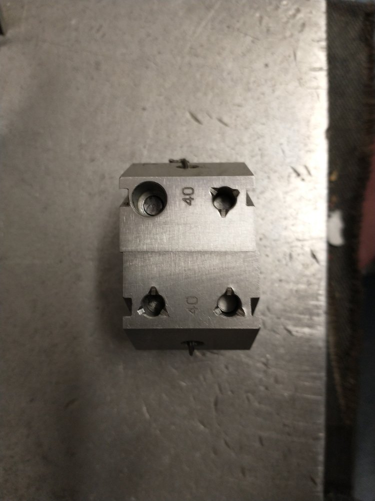

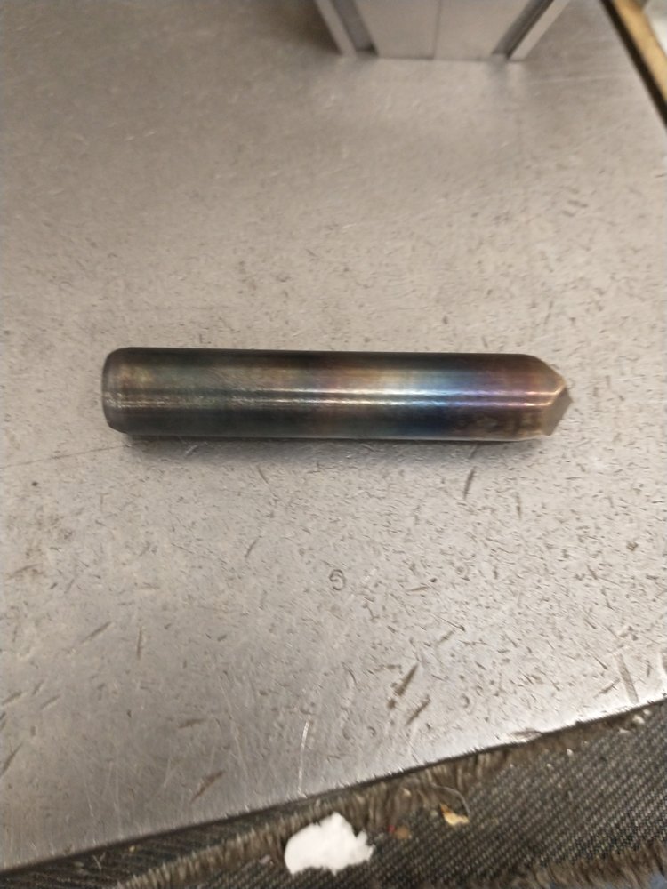

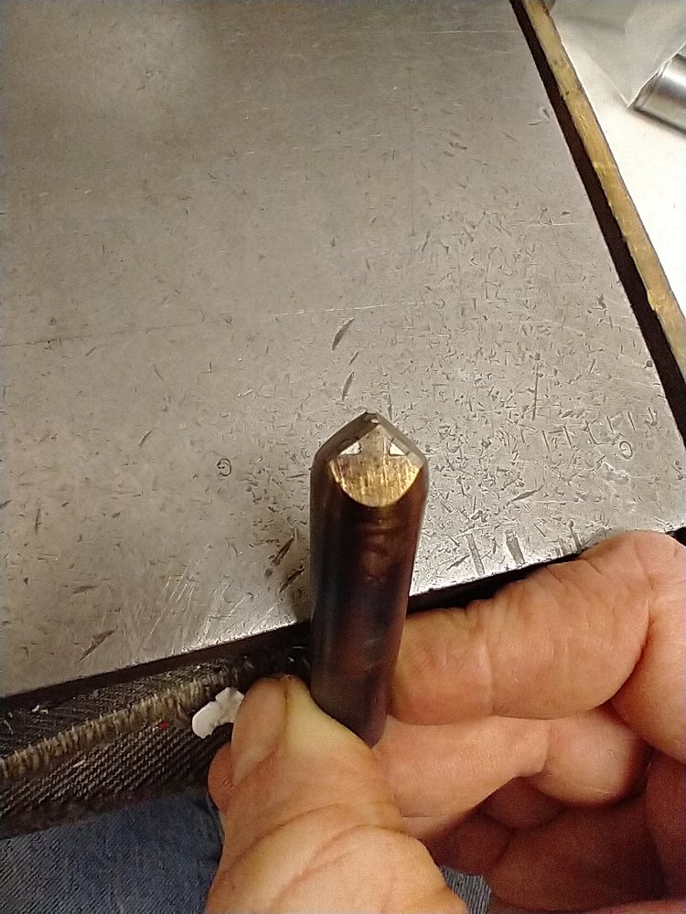

Looks good. Do you press the pin in after? I assumed the punch would have a clearance bore for the pin.After all your help, I went with hardening from the tip end of the punch and quench in water. I then heated from the top end (hammer striking end) and quenched to temper when the tip went just past straw and a little bit more by the looks of it, its holding its shape ok so far
