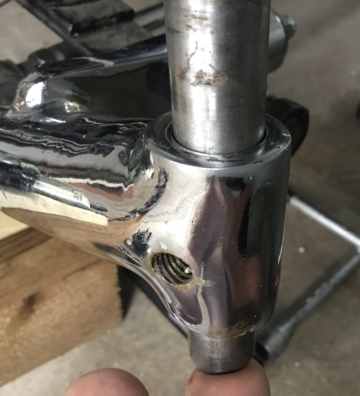

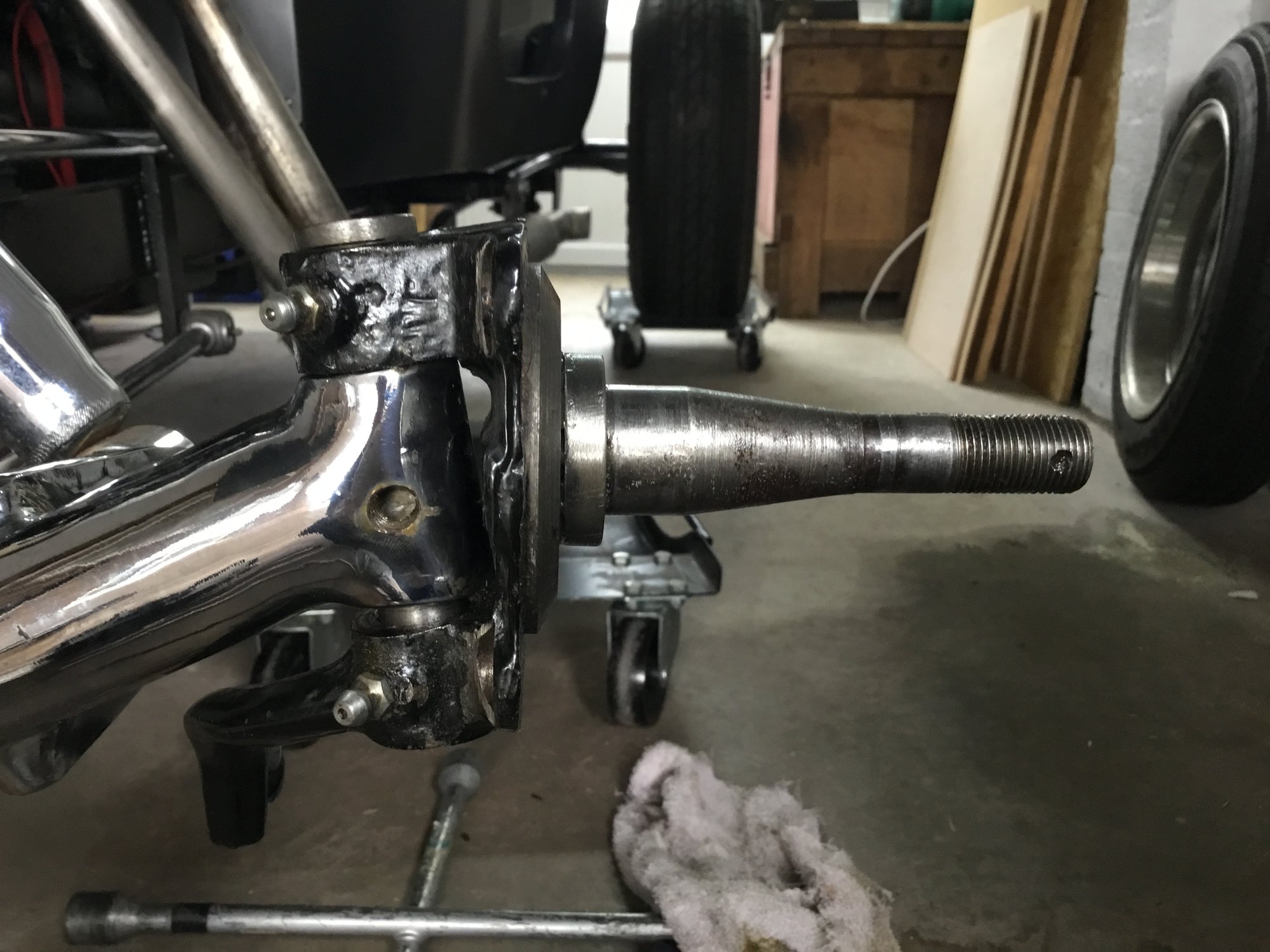

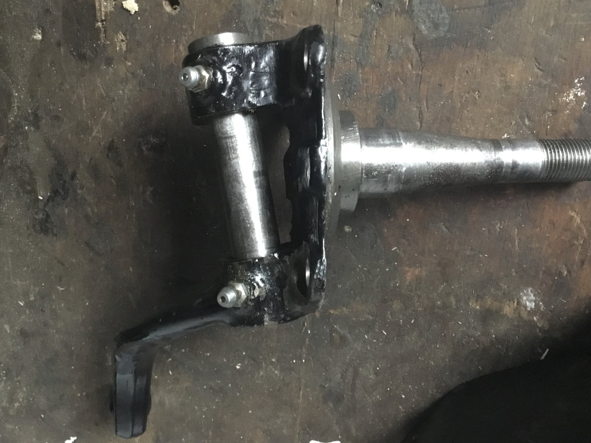

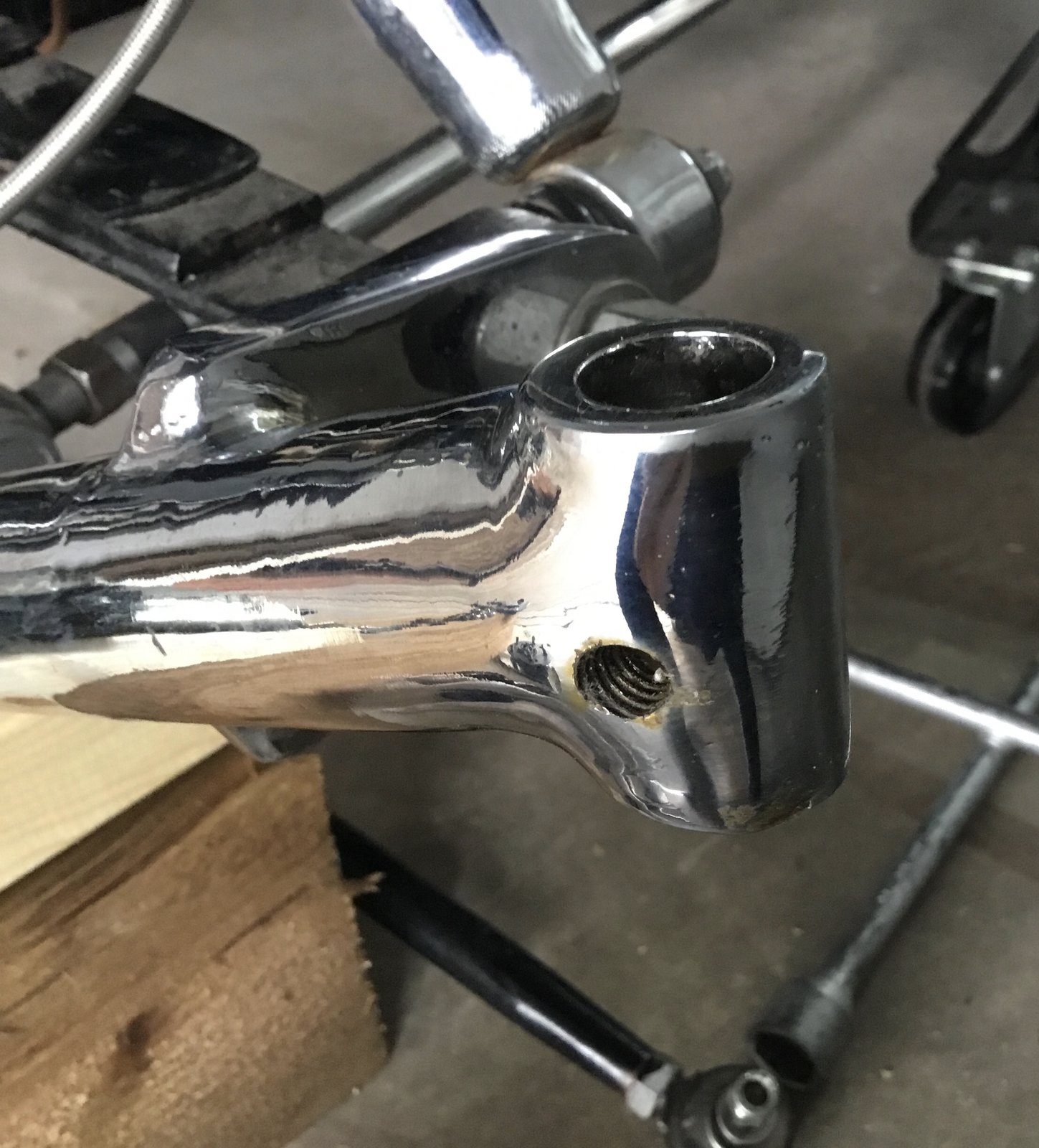

I have a hot rod tube axle with worn king pin holes, and I’ve toyed with running some weld along the outer end, to heat shrink back to size. Not a keen fan of that idea though, but I wondered if going up from 11/16” to 18mm with an adjustable reamer, both axle and bushes would be an idea?
Silver steel, which is good quality carbon steel, ground finish, sounds perfect for the job.
I’ve just ordered an adjustable reamer the right size, from RDG, but for £12 I’m not expecting the greatest tool money can buy.....
