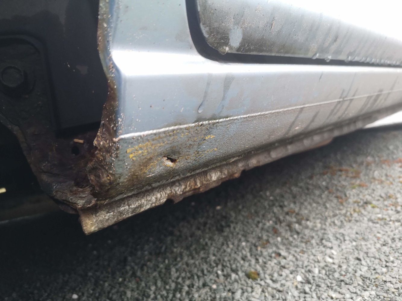

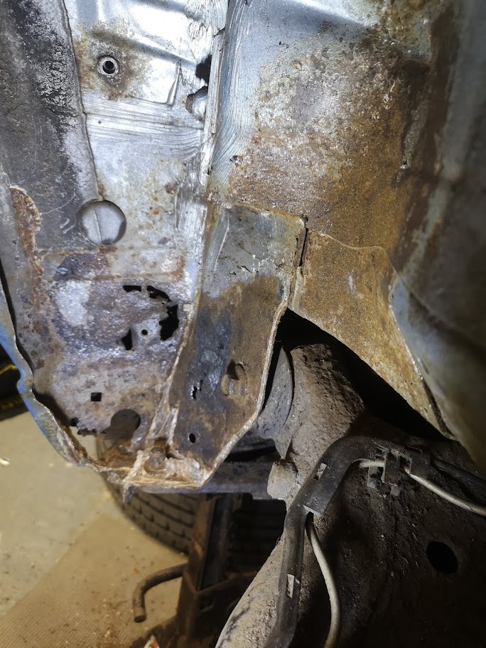

My runabout (Jazz) failed MOT on both sills, at the rear.
I am going to patch weld. I know the requirements for a continuous weld, and the technique of joining spots to minimise warpage. I'll do some practice butt welds on sheet metal first.
Question is really about painting it.
I think I'm happy to just go with matt black, although I'm also happy enough to try any other colour - I was going to do the wing mirrors and bonnet anyway, and not necessarily in the proper colour. This car was a freebie from my sister, but I like using it because my other car is a big boat with a silly engine.
I was going to apply stone chip shield, then overcoat with 2k clear over basecoat, since I have some of that stuff in various colours, and thinners including fadeout thinners etc.
But I'm kind of unsure where to fade out to, or if to just stop at that horizontal line where the factory stone chip shield stops. I realise clearcoat can't be blended, and will peel at the edge eventually, but I don't really have much choice, do I? The sill and quarter panel are finished as one.
So I am thinking I might paint up to that stonechip-line that you can see.
What do you think?
The car was free, it's my "ideal car-body welding project" car, so don't tell me to take it to a pro please!
