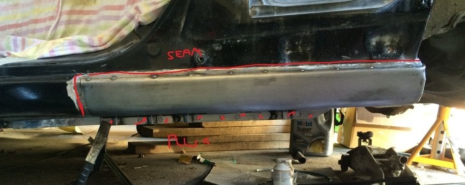

I've recently welded on a new sill section to my car. I plug welded along the seam and looking down from the yet to be completed inner wheel arch, so looking from above at the flanges I have plug welded it looks so susceptible to water getting in by capillary action. I did coat all the metal with weld through primer prior to welding
Obviously I will seam seal along the bottom (apart from the drain holes that are built as little kinks in the outer flange) but Ideally I'd like to seal the top too whilst i have some access as this car is prone to water getting into the sill cavities (hence the drain holes and the whole need for this work in the first place). i say "access" in that I can probably reach the first 100mm of the flange by hand from the arch, but there is about 700mm of newly welded sill I would like to access. I guess I could try some sort of cavity wax and a lance, or some very thin epoxy primer and some sort of tube to get it down there. The car is sloped forward currently so that would help it run down to the areas I can't access.
So... I guess I'm just asking for advice on products and/or techniques/ideas to prolong the life of this repair.
