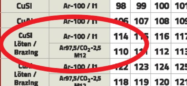

I'm restoring a tubular steel chassis, which was originally bronze-welded/brazed using a torch and bronze filler. I've found a seam which has cracked and I'd like to find a way to repair it at home if possible. I've found a pro who says they can TIG it with silicone bronze, but it's PITA to transport it and there are no aesthetic considerations because this joint is hidden. I have a MIG welder that I use purely with steel wire, but have seen that silicone bronze wire is available. Do you see any reason why I couldn't use it in this application, where the new silicone bronze filler will be joining an existing brazed seam? Do I need to worry about compatibility of the silicone bronze MIG wire with the bronze previously used?
My other question concerns shielding gas - is it critical to use 100% argon or can I get away with the 75/25 Argon/CO2 mix I already have?
