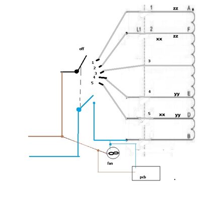

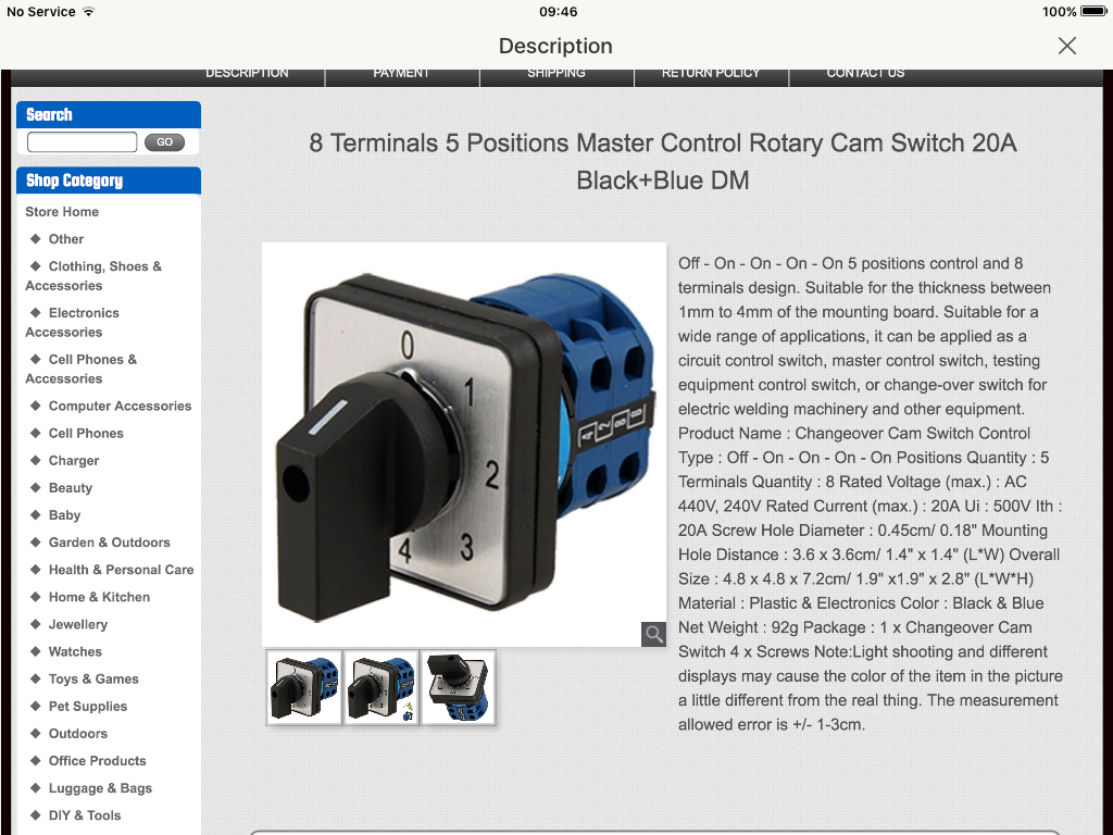

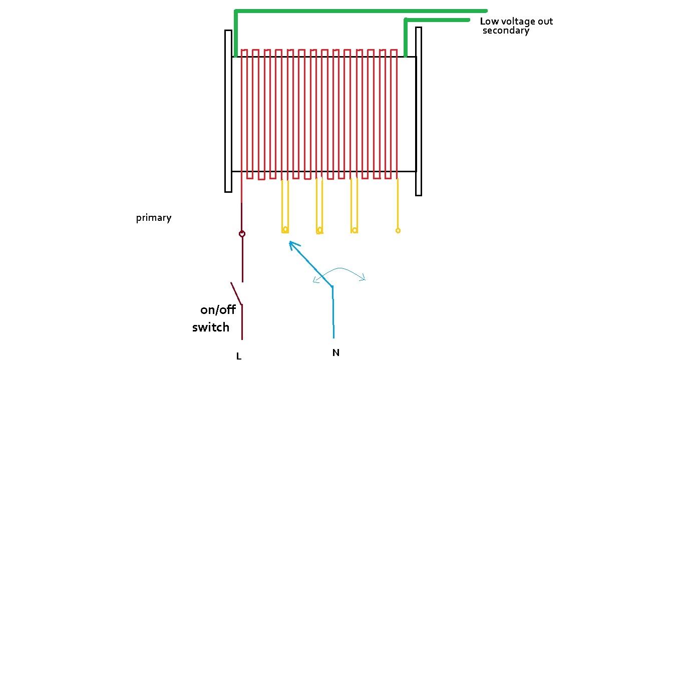

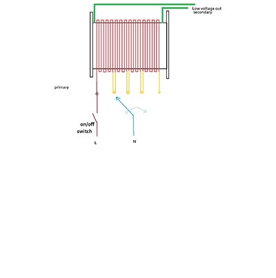

When new switch comes I will connect it up and try n fix old switch ,

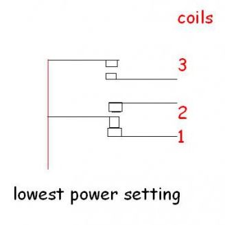

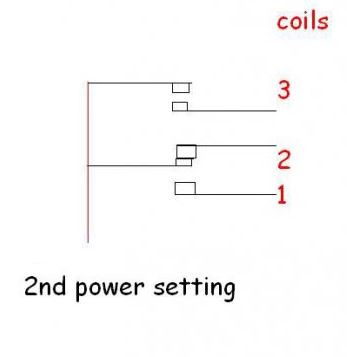

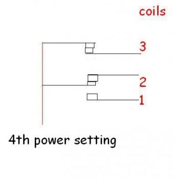

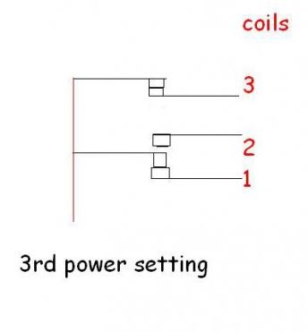

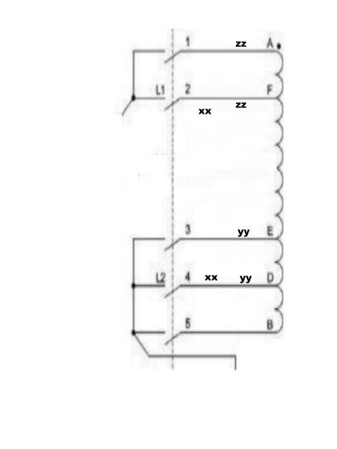

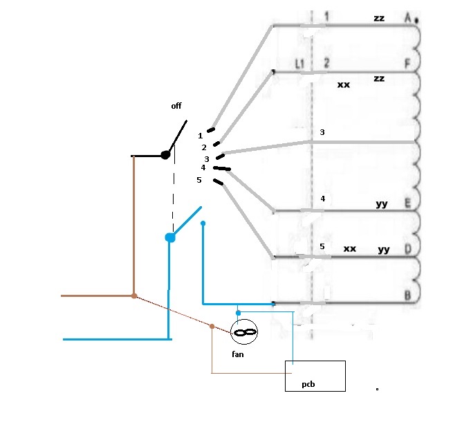

Hello snooper it's starting to sink in now ,I think I can use knob centre rod to change how switch opens n closes between 0 to 5 by doing one at a time ,I never did this when I refitted old switch ?If you put in the links they won't do anything unless the contacts are closed internally those switches are often worked using cams so as you turn it the first contacts will close for position 1 then open 1 and close position 2 then open 2 close 1 and the connection for the 3rd coil then open 1 close 2 while keeping the 3rd coil connected for the 4th setting
It's quite possible, you would t know until you tryHello snooper it's starting to sink in now ,I think I can use knob centre rod to change how switch opens n closes between 0 to 5 by doing one at a time ,I never did this when I refitted old switch ?
