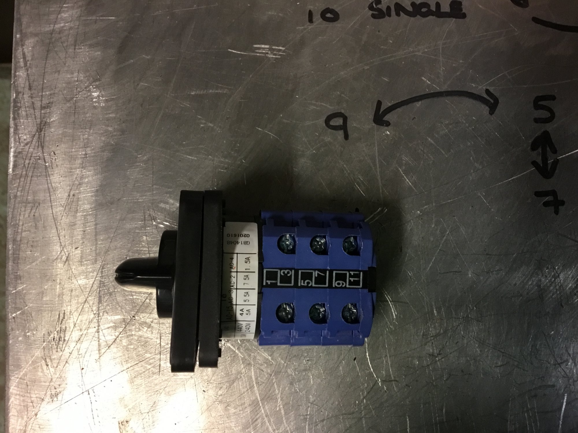

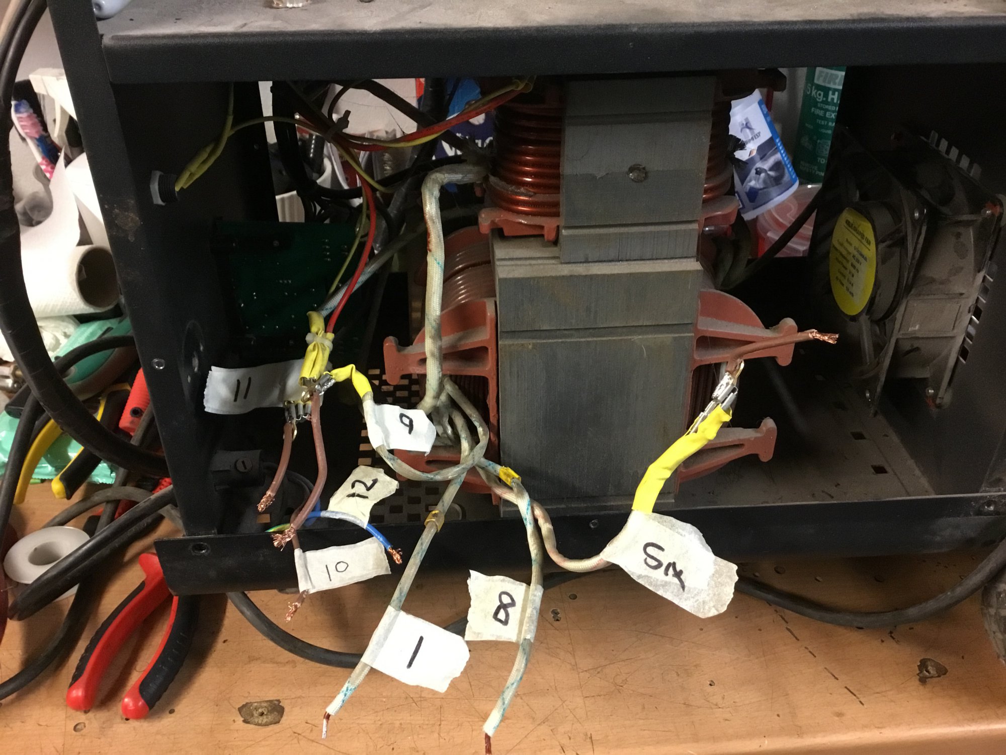

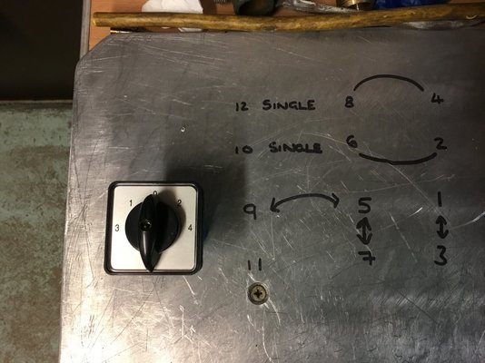

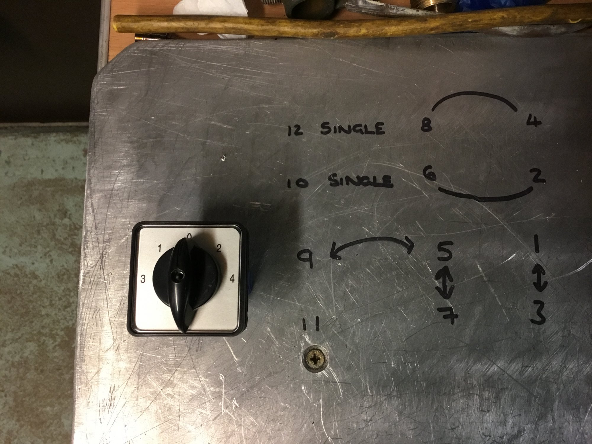

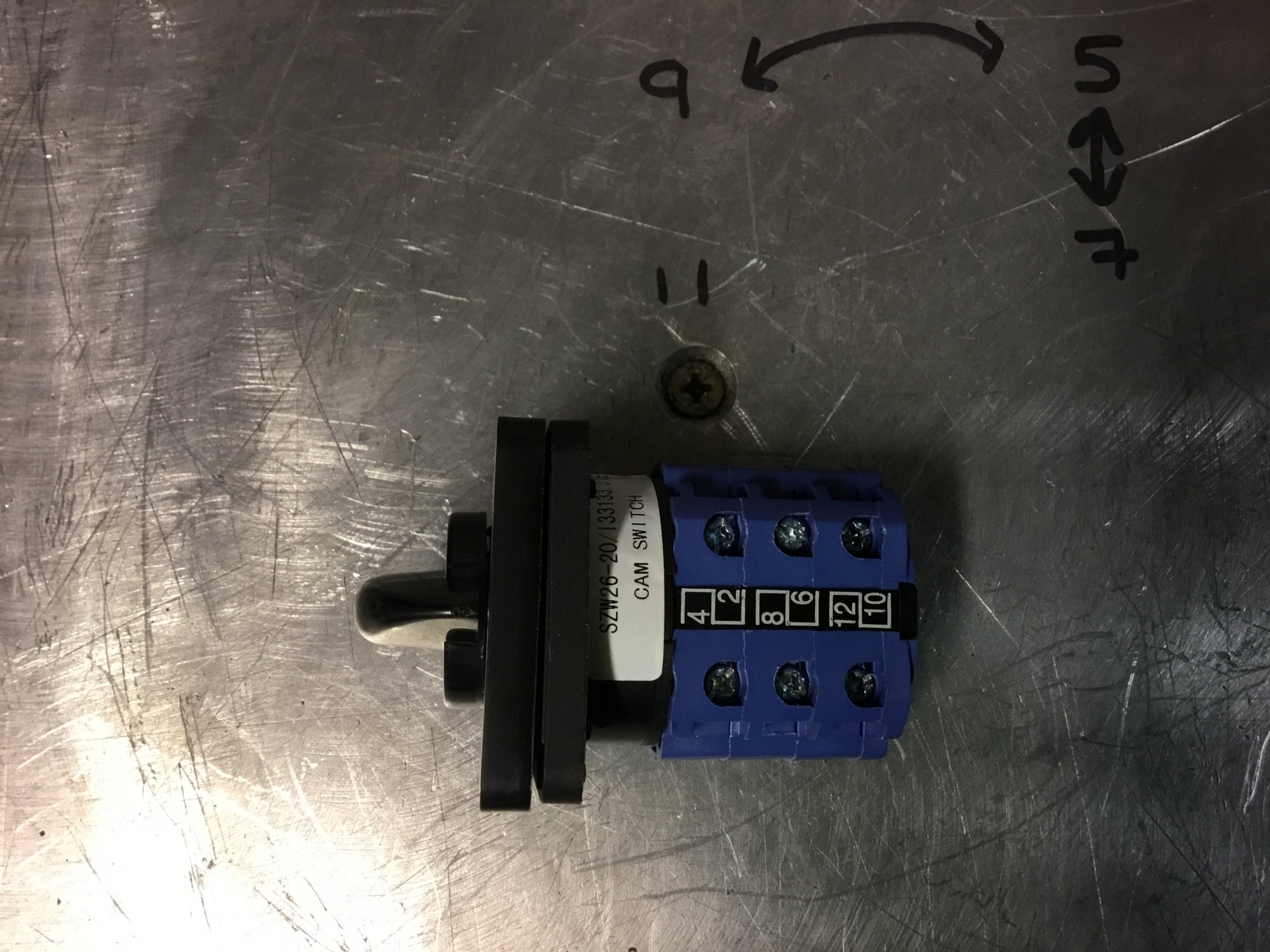

The sticky bit now is the power switch,it only worked on 2 of the power positions but welded well,so I thought I would replace it as the original looked like it had been slightly getting hot and melted and thought that was the problem,I have bought which I think is a replacement dial but after numbering all wires and putting back together Ive now only got 1 power setting so think I've got something wrong or switch is numbered in a different way,I know this has been asked many times as did look through old posts but haven't been able to find an answer to help,so sorry if it's all been gone through before.
I've taken some pics if it helps at all?
Thanks for any help you can give me
