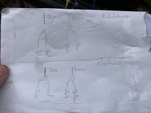

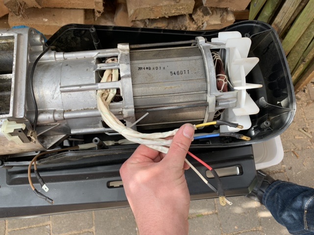

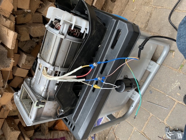

Hi all

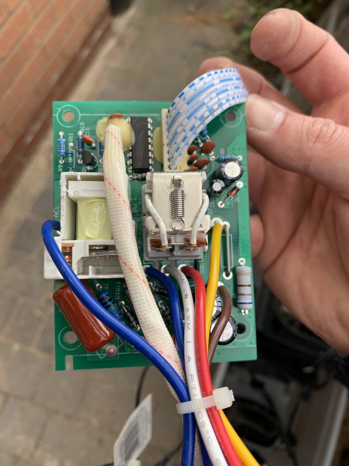

I have a use for this old shredder motor.
The control pcb was blown and managed to get another of the same shredder with a knackered gearbox so swapped all the good mechanical stuff from mine with the good electrics from the other to get one good shredder.
This leaves me with this motor and no controller
I believe it to be an ac motor but what do you guys think?
How do I test it and how do I wire it up just to make it work?
It has 4 wires coming out of it
Blue,red,white and a yellow
The red and white have continuity and so do the yellow and blue
But not with each other.
Hope this makes sense all I want to do is run the motor with an off/on switch or contactor. It had the abilty to go in reverse too, is there a way to wire it to do that?
