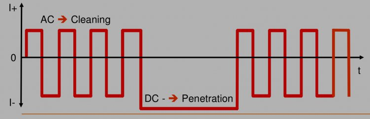

I've been using mixed arc for welding Aluminum for a while, and weld wise all is good. I run 200 ish amps DC, 60% of the time, AC at 60% of that current. The AC is 250Hz, square wave, 62.5% EN. I am welding thin to thick, say 1" to 1/8", and get deep penetration and narrow welds.

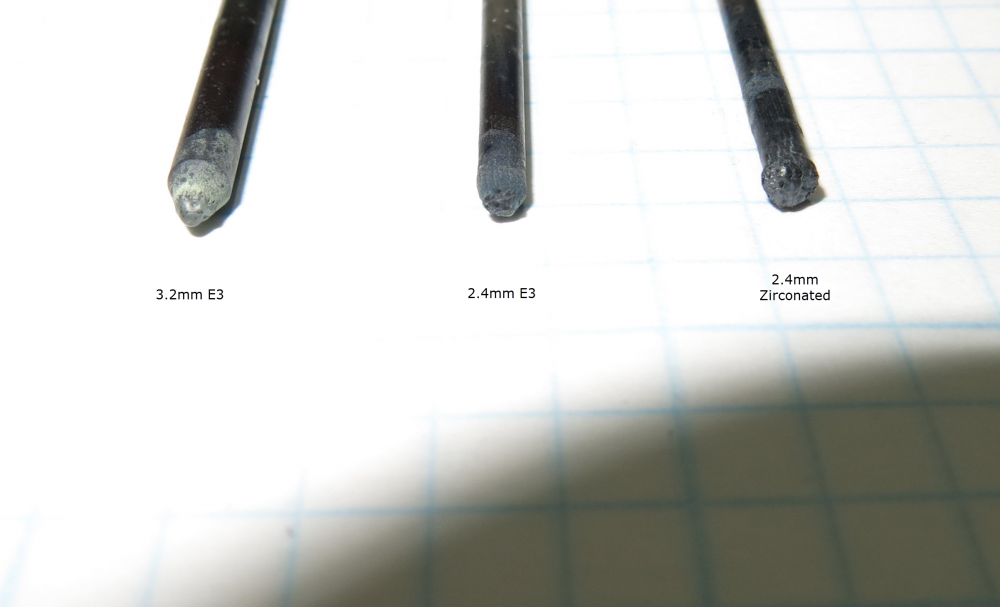

The problem is tungsten life. The ends of the tungstens are shredded, like when you get a split, except I get 20 splits. Tried all kinds, zirconium doped, lanthanated, even thorium doped. The best results are with rare earth (E3) in 1/8", one size up from what I usually use. They still shred, but last longer. Prep is a short cone, no ball as per Kemppi's recommendation. I end up regrinding every 10 minutes.
