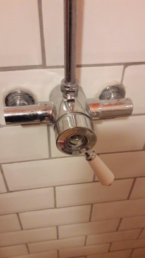

A Am333rcr Member Messages 822 Feb 7, 2021 #1 hi my shower is acting up. Is the thermostatic shower bar. water inlets adjustable? so it can fit into my set face plate in the wall. thanks again i do help where i can i dont won't to abuse the forum and give nothing back

Tigman Forum Supporter Messages 3,906 Location Watford UK Feb 7, 2021 #2 Most bar mixers are the same size , show us a picture
A Am333rcr Member Messages 822 Feb 7, 2021 #3 i thought the hot and cold are adjustable but cant remember 100%. its a bristan. i got a bristan face place from screwfix

mike os just a little insane..... Messages 9,652 Location North Wales Feb 7, 2021 #4 The canters are standard so should just swap
Kayos Gone...... Messages 9,910 Location North Lincolnshire Feb 7, 2021 #5 Mira do one that would fit straight on there
the snooper getting older by the day Messages 21,063 Location Hull UK Feb 7, 2021 #7 Am333rcr said: i thought the hot and cold are adjustable but cant remember 100%. its a bristan. i got a bristan face place from screwfixView attachment 273596 Click to expand... Looks like the temp adjustment is missing from the centre

Pete. Forum Supporter Messages 15,097 Location Kent, UK Feb 7, 2021 #8 Is that one of the type that uses a wax cartridge? If the hot and cold water pressure are vastly different the catridges don't like it. I've had to change mine several times over the years until I got the cold water supply to the shower reduced.

Tigman Forum Supporter Messages 3,906 Location Watford UK Feb 7, 2021 #9 Get a new bar mixer for that no problem
A Am333rcr Member Messages 822 Feb 7, 2021 #10 i have only had it 5 years. i am not sure if its wax or not. or the flow rates. i think i can get a cartridge for it from screwfix
