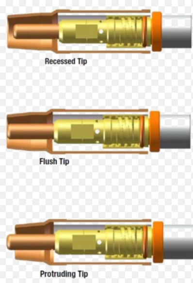

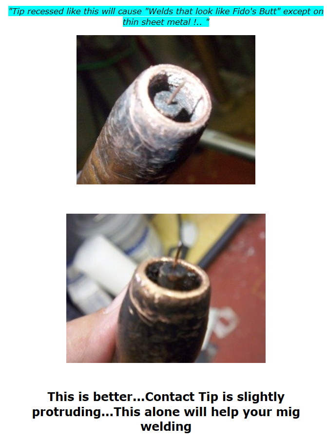

I don't think I've ever seen a protruding tip on a torch set up for mild steel. Usually just recessed. And most welding I see/do is heavy stuff.
Depends i normally run with flush but do keep some ground down in a bag with my fresh tips
Flush to just under the shroud face in 99%
