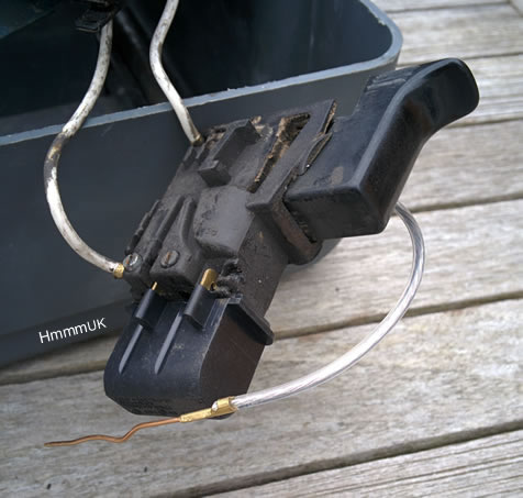

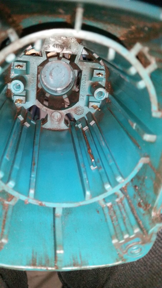

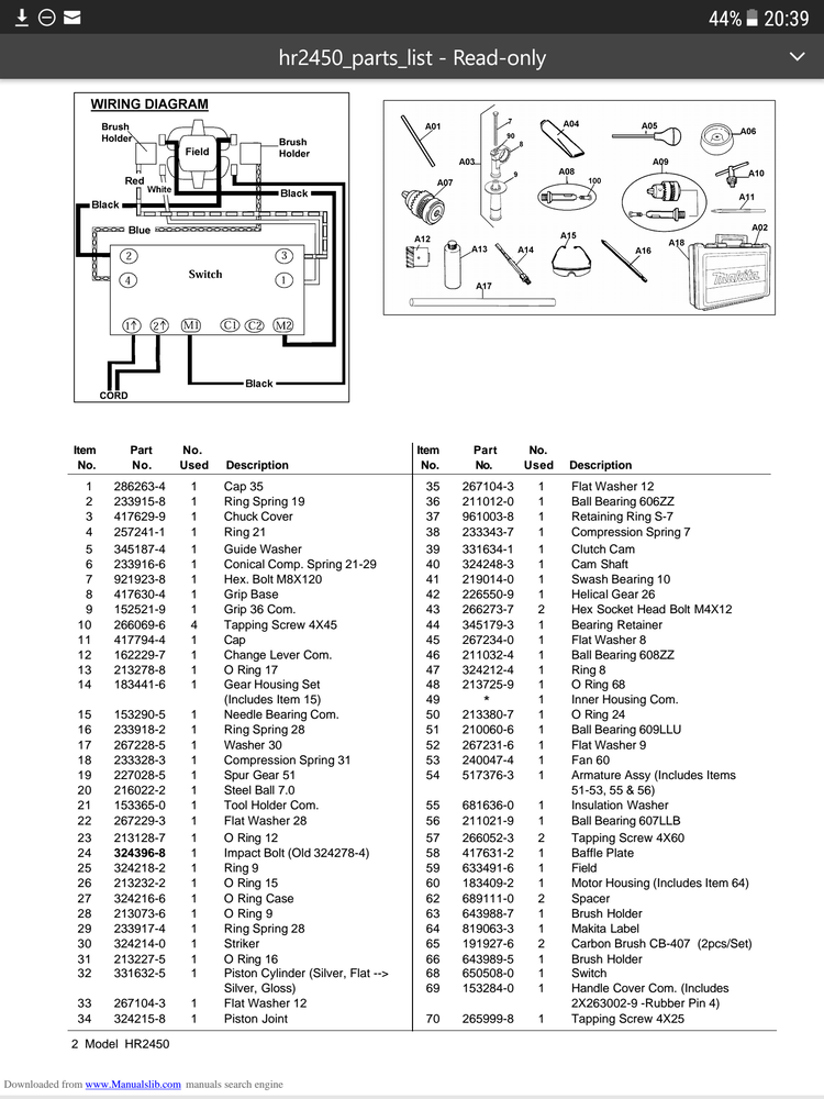

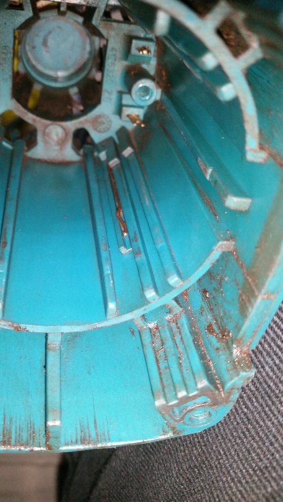

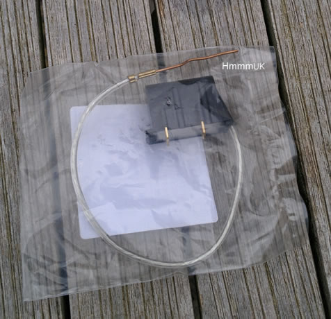

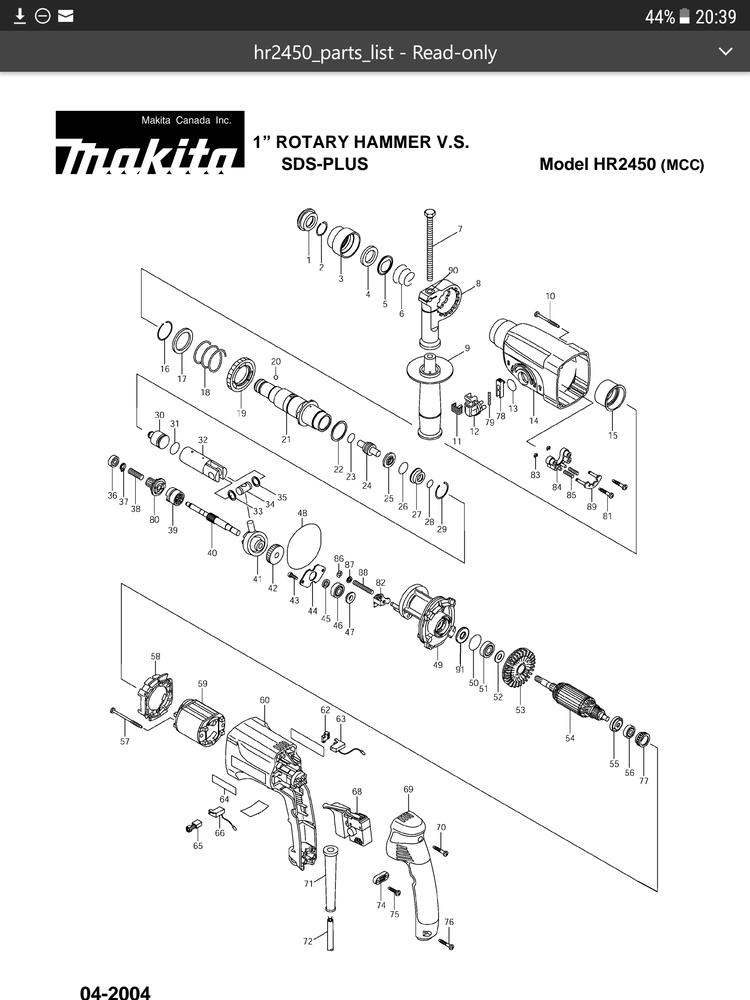

The wiring diagram included in the parts list shows a connection to the laminated core of the motor stator. I assume that connection is via the kinked solid copper wire. It then becomes a white wire which is connected to Pin 1 of the trigger switch. The power cable for the drill is 2-core, so there is no AC earth, but maybe the stator needs to be "grounded" to part of the speed control circuit in the switch.I cannot see the wire in the parts list.
