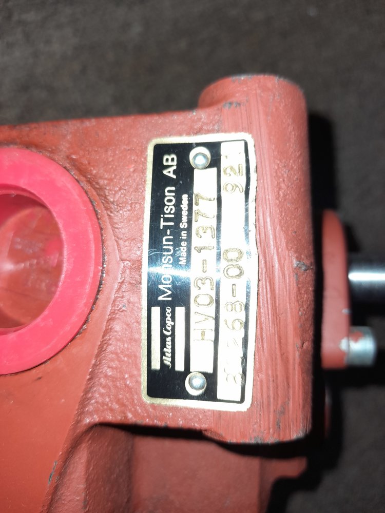

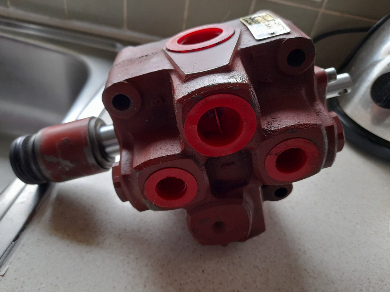

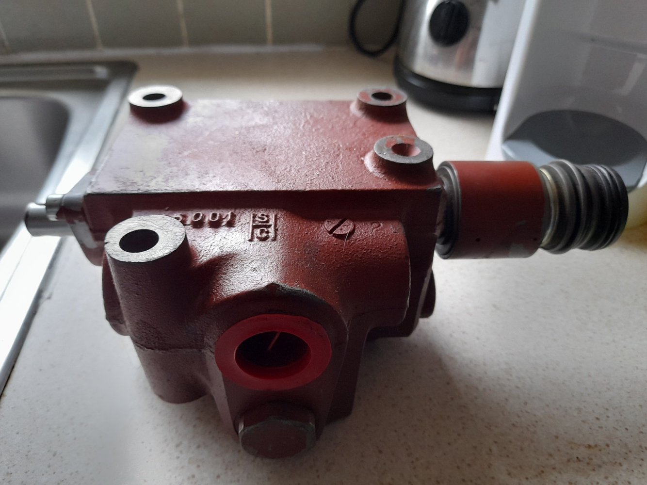

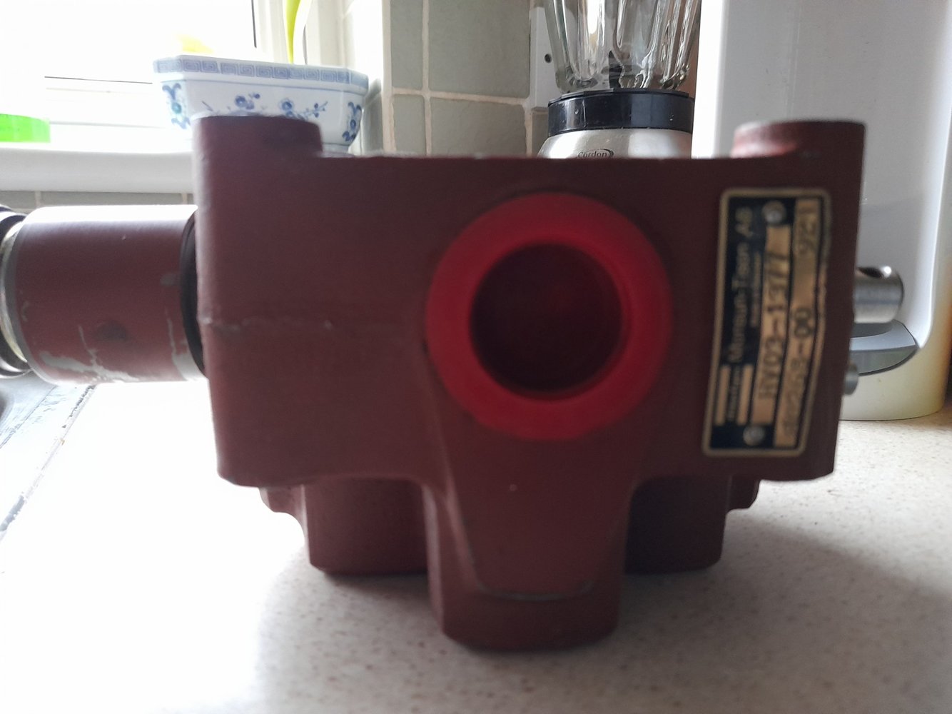

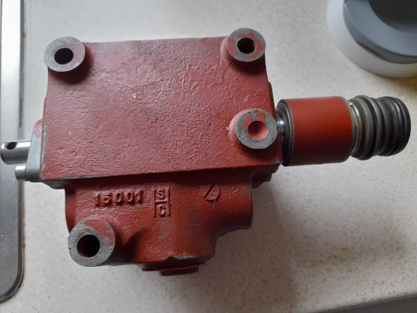

Seadog Save the planet. It's the only one with rum! Messages 13,213 Location NE London - UK Jan 10, 2022 #21 It's a directional control valve.
A awemawson Forum Supporter Messages 4,810 Location East Sussex, UK Jan 10, 2022 #22 Yes but is it 'open centre' or 'closed centre' ? (It may need a PRV fitting in one of the ports if that is just a blanking plug.)
AndersK Member Messages 1,469 Location Sweden Jan 10, 2022 #23 That is an Hv03 hydraulic directional valve, made in my hometown Withdrawn from production many years ago so spares rare as hens teeth. Monsun-Tison was bought by Atlas Copco. Then merged with Volvo Hydraulics into VOAC Hydraulics and eventually bought by Parker Hannifin.
