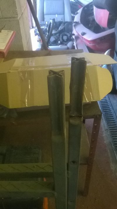

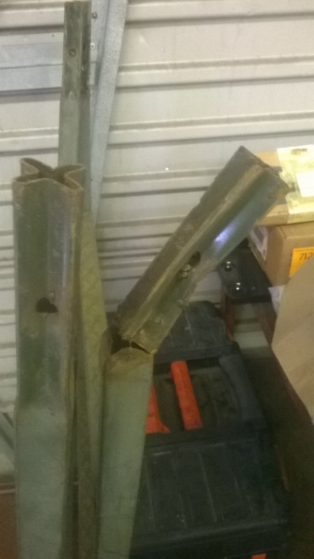

So, the initial problem;

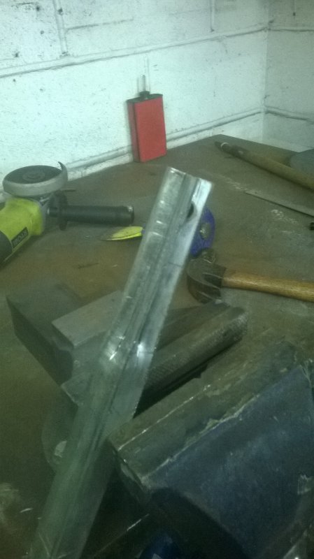

Doesn't leave the ladder very secure to the actual chair, so something had to be done. Luckily, I've got a bit of 25mm box with a 1mm wall, so patching a repair section in can be done really quite cheaply.

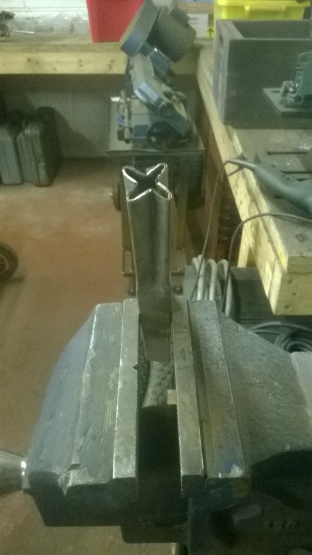

A rough mark of how deep to insert the section in to the seat base was made, and the centre of each face marked, then scored with a 1mm slitting disc to make life a little easier.

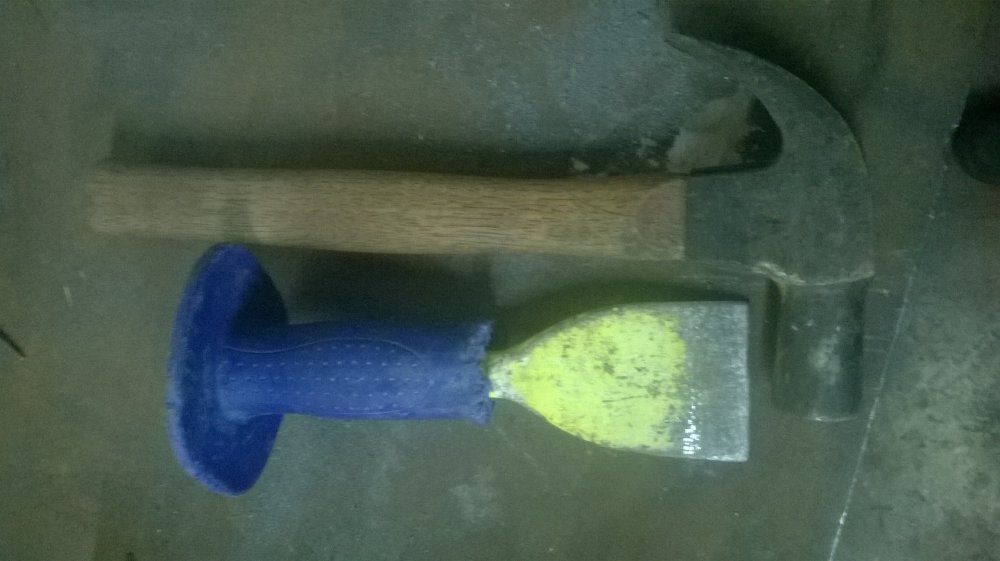

The tools required, I should have used a bigger hammer, but this little persuasion stick proved enough eventually.
Bang, bang, bang, bang. Turn. Bang, bang, bang, bang. Turn. Bang, bang, bang, bang. Turn. Bang, bang, bang, bang.

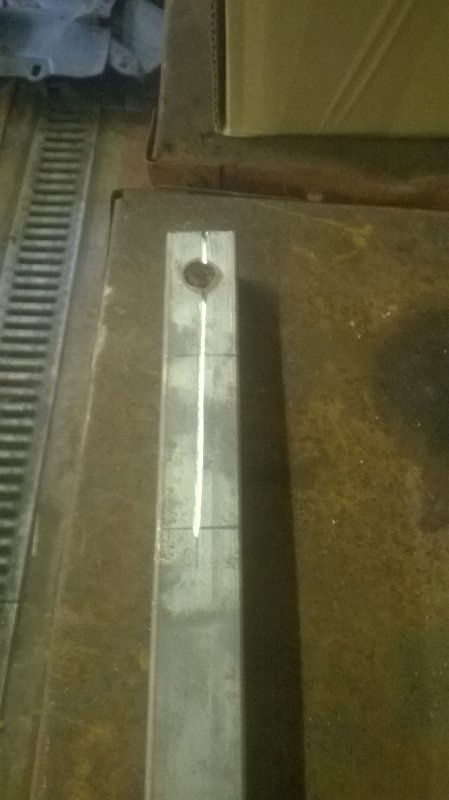

Needs a hole drilling through for a securing bolt, but the trial fitting was successful. Need to make another for the other side of the ladder, and replace a cross section too.
