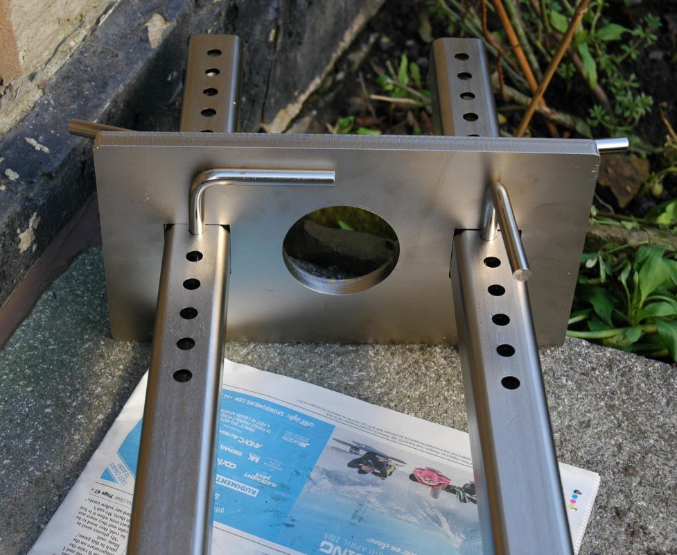

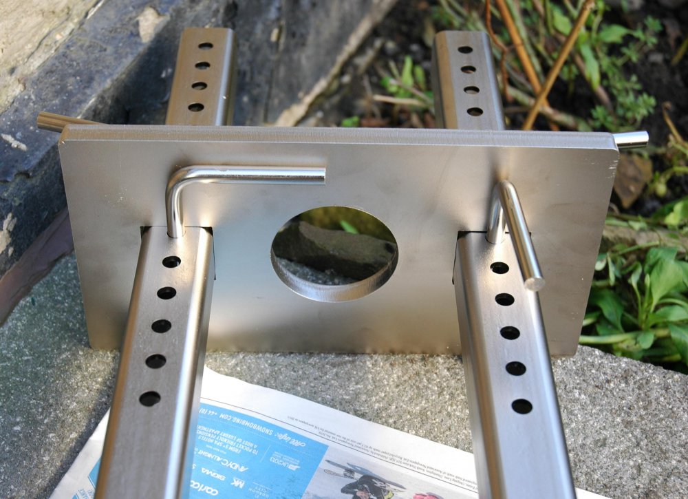

I've recently been getting a lot of stuff electroless nickel plated. It's a lot like stainless, only slightly 'warmer' in tone, and has good corrosion resistance, especially when the coating is applied slightly thicker than normal. One of its major advantages is that it gives a consistent depth of coating, irrespective of contours, holes, edges etc, unlike chrome. Here's a picture of what the surface looks like. This is mild steel plate/box section/rod coated in ENP.
And where do we go to get it done?I've recently been getting a lot of stuff electroless nickel plated. It's a lot like stainless, only slightly 'warmer' in tone, and has good corrosion resistance, especially when the coating is applied slightly thicker than normal. One of its major advantages is that it gives a consistent depth of coating, irrespective of contours, holes, edges etc, unlike chrome. Here's a picture of what the surface looks like. This is mild steel plate/box section/rod coated in ENP.

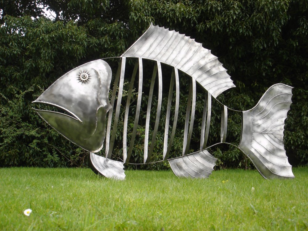

I have two customers asking me about making them big shiny fish like this. One has asked for stainless steel; Which I think would be a disaster on the head with all the welding involved. I also dont like using stainless. The fish in the photo was cupbrushed mild steel. A lovely finish.
