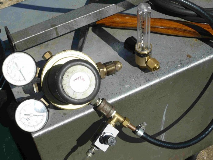

Hi, I wonder if someone can help.
After consuming a 10 litre cylinder of argon rather quickly I thought that I'd better get a flow meter to check that my gas flow was around the correct value (10 litres per minute I believe)
My problem is how do I connect this into the existing "plumbing"?
I have a two stage regulator with gauges that show bottle pressure and "output" pressure. This has what appears to be a 1/4 BSP male/male nipple, one end of which screws into the regulator and the other into a 1/4 female/female malleable iron coupling. The other end of the coupling goes to a T piece which has a valve controlled feed to a plastic tube (for flooding the inside of tubes etc. to minimise oxidation) and the other output goes into the welder and eventually to the torch.
The flow meter, one of Weldequip's finest appears to have 3/8 BSP fittings.
What's the best way of plumbing this into the system? I thought that a 1/4 to 3/8 male/male nipple with a cone end from the regulator to the flow meter and a 3/8 to 1/4 female to female with cone end from the flow meter to the rest of the existing plumbing should do the trick. If so where's the best place to get one off of each of these, or is there a better way?
Regards and sorry if this sems a trivial query.
Wannabe
