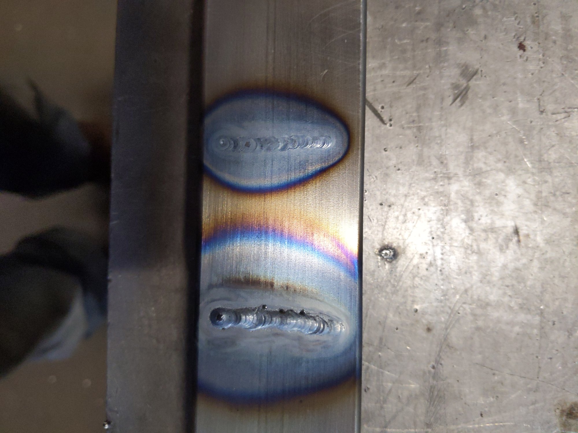

Hi,
I was incredibly happy unboxing my new Sherman 206p after years of working on a simple basic Berlan 200 DC welder. This should be a treat from now on right? Well... There is some issues I just cant get my head around and maybe there is somebody that could help me with that. First off: I'm no slouch when it comes to DC Tig welding, been doing it for years now, semi professional with regular assignments.
I raise you the following scenario: 2mm mild steel - 1s preflow, 10A Starting amps, 0s Starting time, 80A Peak Amps, 1s Downlsope time, 15A Downslope, 1,5s Postflow. Flowmeter says 8l gasflow.
So:
1) The Arc only ignites when the tungsten is like 10mm away from the workpiece. If it was lets say 2mm away it sounds like an old spitfire and it will never ever ignite. Normal or not? Definately very annoying since my 200 bucks DC Tig welder did not do that at all.
2) It doesnt seem to get any power into the weld. When I am test-welding a normal bead it barely melts the steel. Even at 80A it is struggeling a lot. Hence I cant seem to be able to straightforward weld with it since it takes 3-times as long to get a puddle as it did with my cheap old one. (See the attached file: Top is without filler rod, Bottom is with).
3) The 4T welding function cant be turned of. I press it once, it starts, it runs, it cant be turned off again. You could be pressing the button as much as you want.
4) As to be seen in the picture the welder seems to bring in a lot of heat in the surrounding workpiece, instead of the actual bead. This is the same with the tungsten which weirdly turns blue (ergo too hot) without welding much.
I'm slightly heartbroken... Maybe somebody has a suggestion? Does it have to do with the setup of my machine? My old machine couldnt be fiddled around with, I guess it just had a bulletproof ramp for DC welding.
Thank you very much and all the best,
Simon
(PS: Sorry for my english I'm not a native and I don't have autocorrect in this window here)
