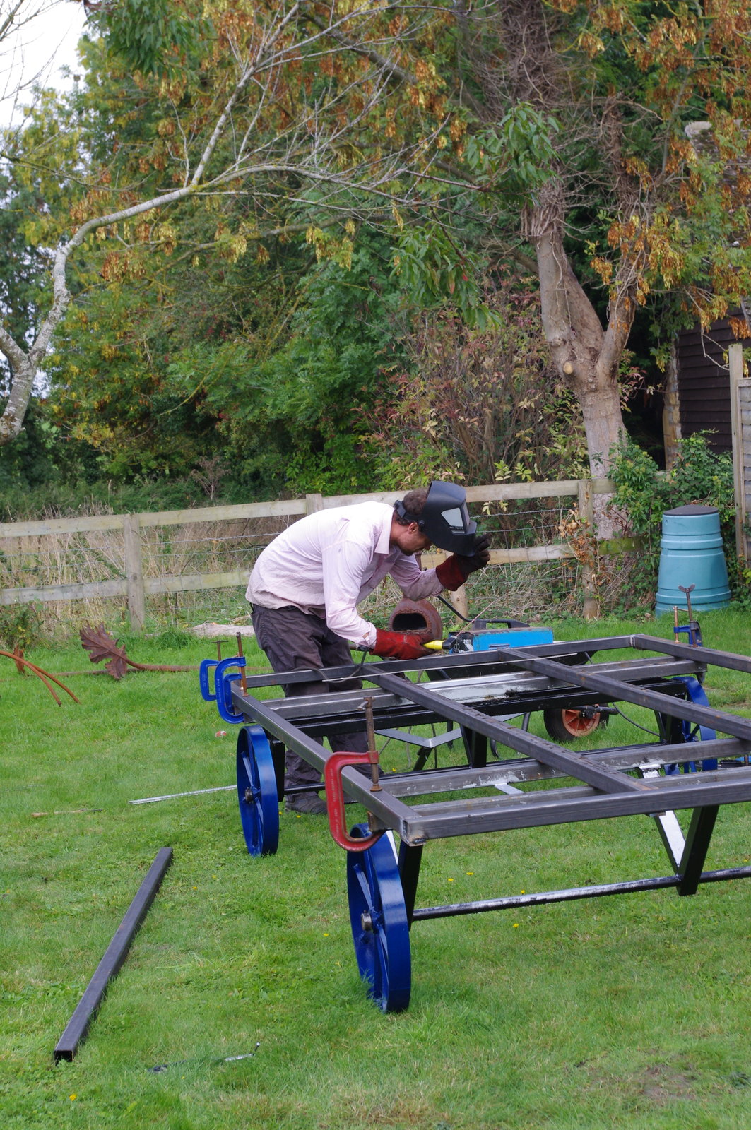

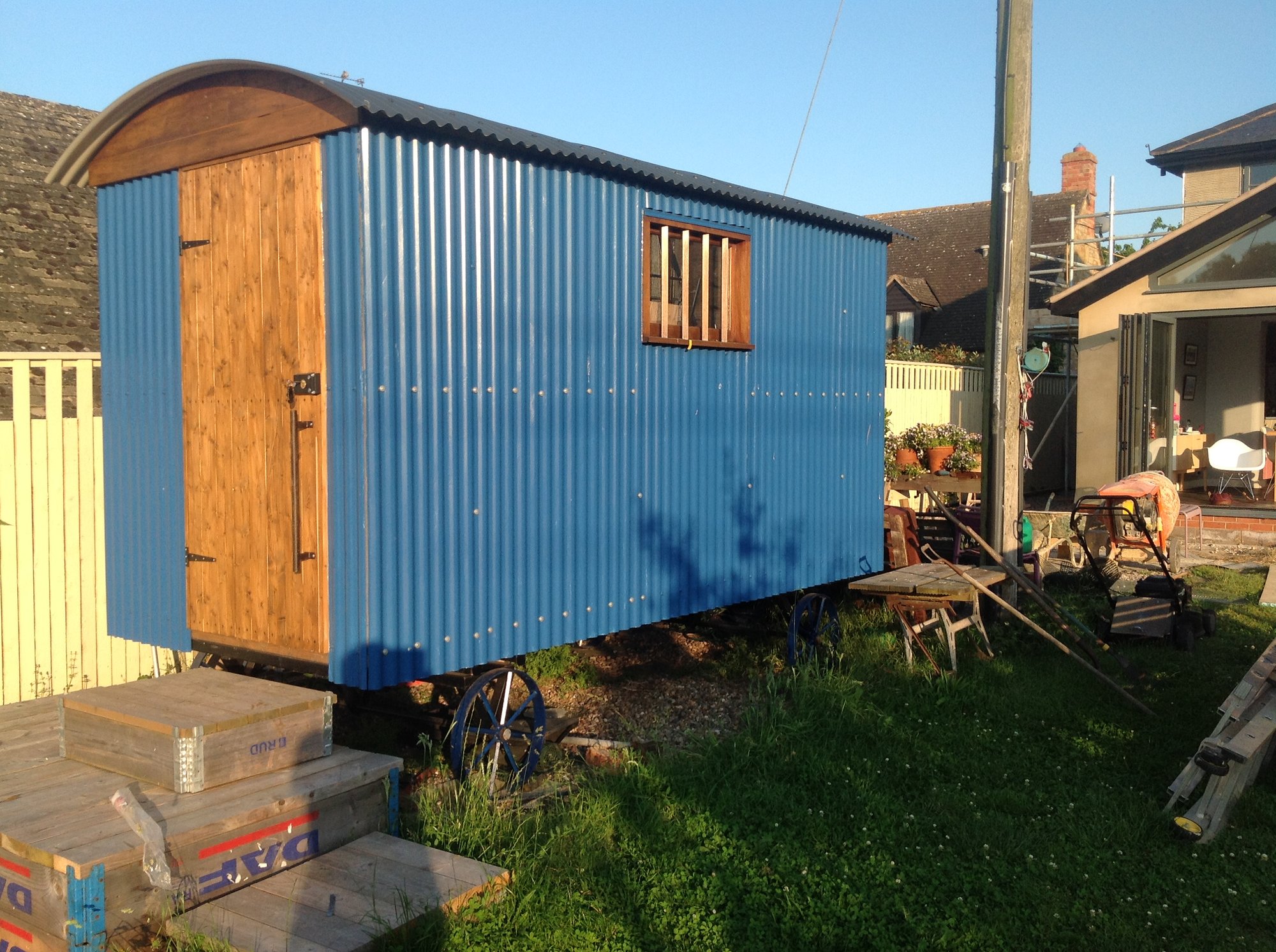

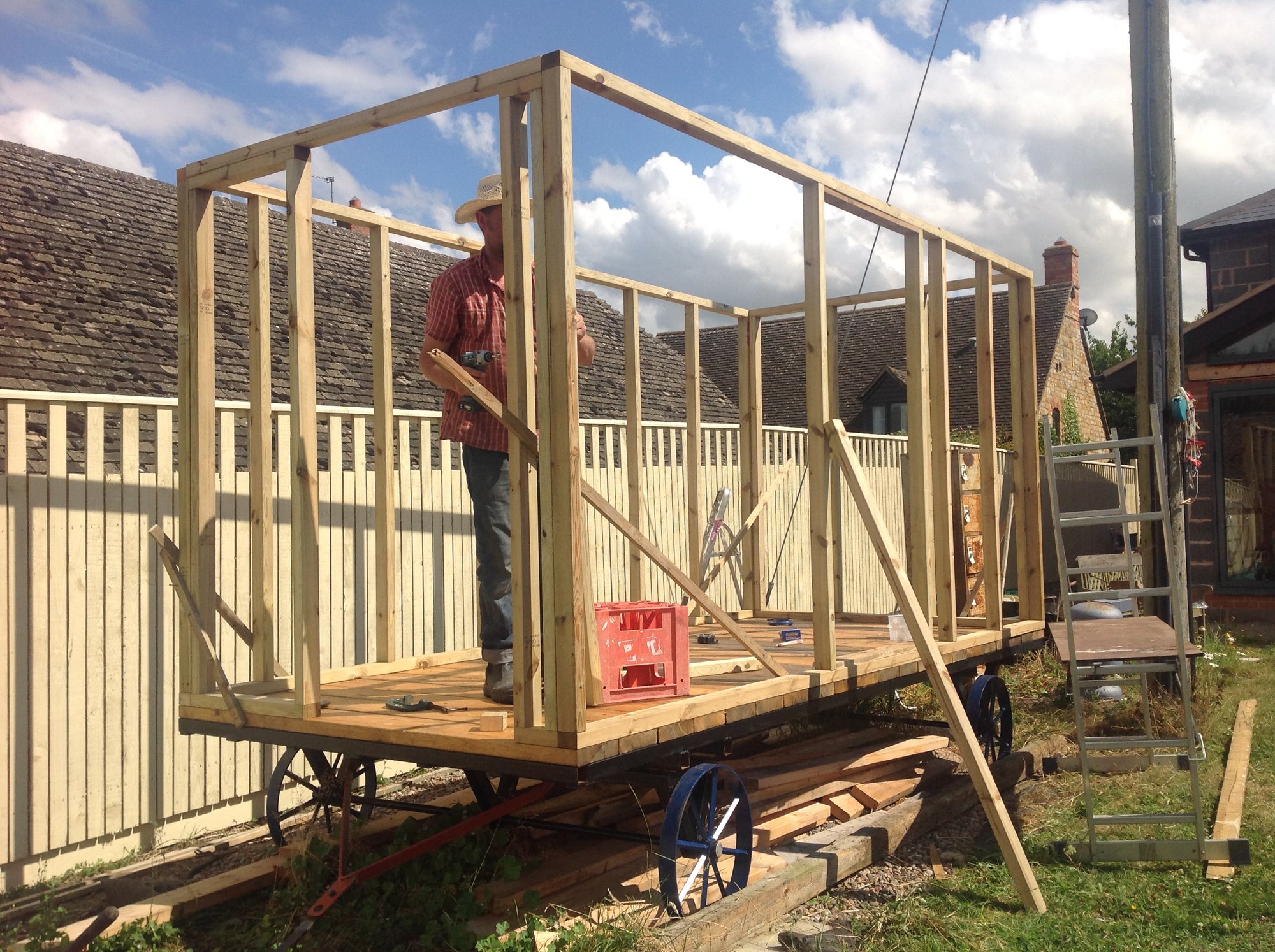

I made a smallish one to use as a garden shed, so not much fancy fitting out on the inside, my best advice is if you're going to use a curved corrugated roof make your hut to fit the standard of the peg size roof sheet, I didn't think of this when I started and had to have my roof sheets custom rolled to size which costs a fair bit more. I'll look out a few photos of building it .

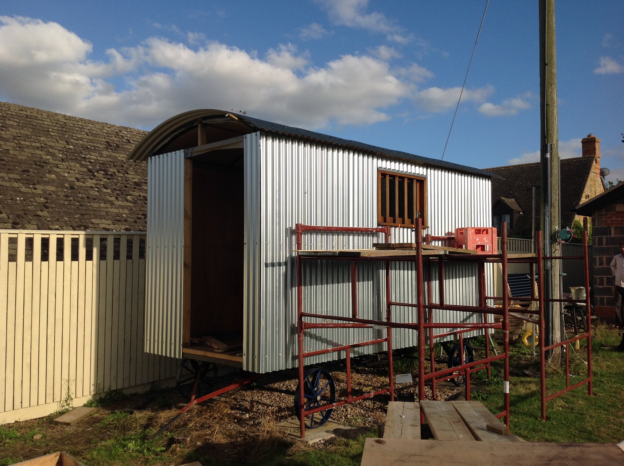

That's the stuffIs that the kind of stuff they make pig arks from?![]()
