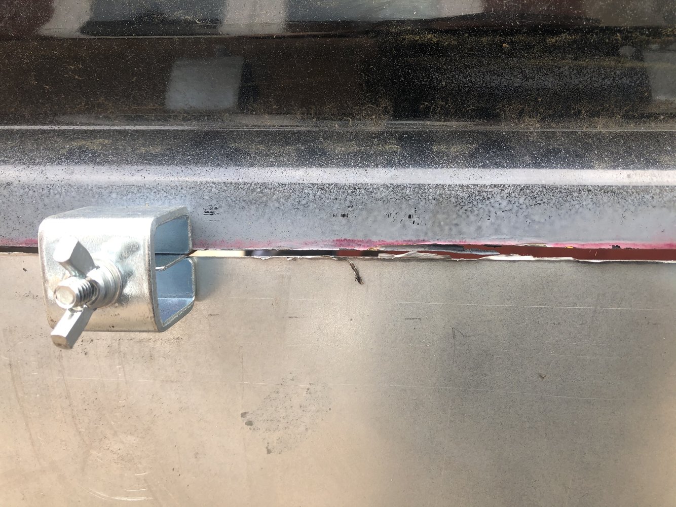

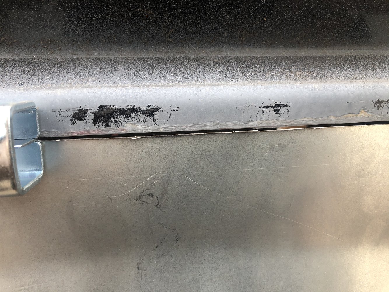

I need advice before I start (mess up) welding in a replacement outer panel on my van.
I’ve cut the new panel to size and achieved a consistent 1mm gap except for one part probably about 10cm in length where the gap is about 2-3mm.
I’m currently using 0.6mm wire would 0.8mm be better to fill this gap?
Thanks

I learnt loads.
Needs to cleaned right back to bright metal using a poly disc (which doesn't thin the metal) If you do have to weld outside, pick a still day especially if you are using gas. Tack first all round and confirm no movement, then don't go for any long runs on that thin metal (however well it's going!) Use a auto darkening mask and use both hands. Practice loads on scrap before going near the van..
