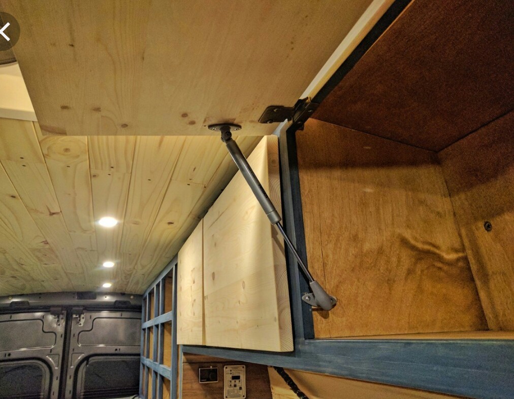

Mines a camper van, Not a work van. But understand what you mean!
built in caravan furniture is made with 3mm ply with an 18mm(ish) fram.
a 2ft x 9in piece of 3mm ply with 18mm square frame around the edge will take being full of books.
