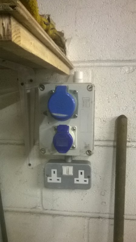

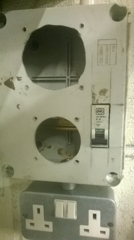

I need to put further provisions in for welders in the workshop, so I've an idea of putting a 32a and 16a connector in a box in opposite corners, so I'm covered wherever I need to weld without the added hazard of excessive extension cables all over.
I split the circuits in the workshop across two RCD protected boards, mainly due to the number of circuits, but it also leaves one bank of lights on should I trip an RCD. Now, these boxes will be off a different distro for the same reason.
Question is, can I share a neutral and earth in the boxes to save pulling three 6mm2 and three 2.5mm2 singles through a conduit run? Both connectors will be on separate MCB's.
Its also tempting to drop a double 13a under these boxes too, daisy-chained from the 16 or 32.
