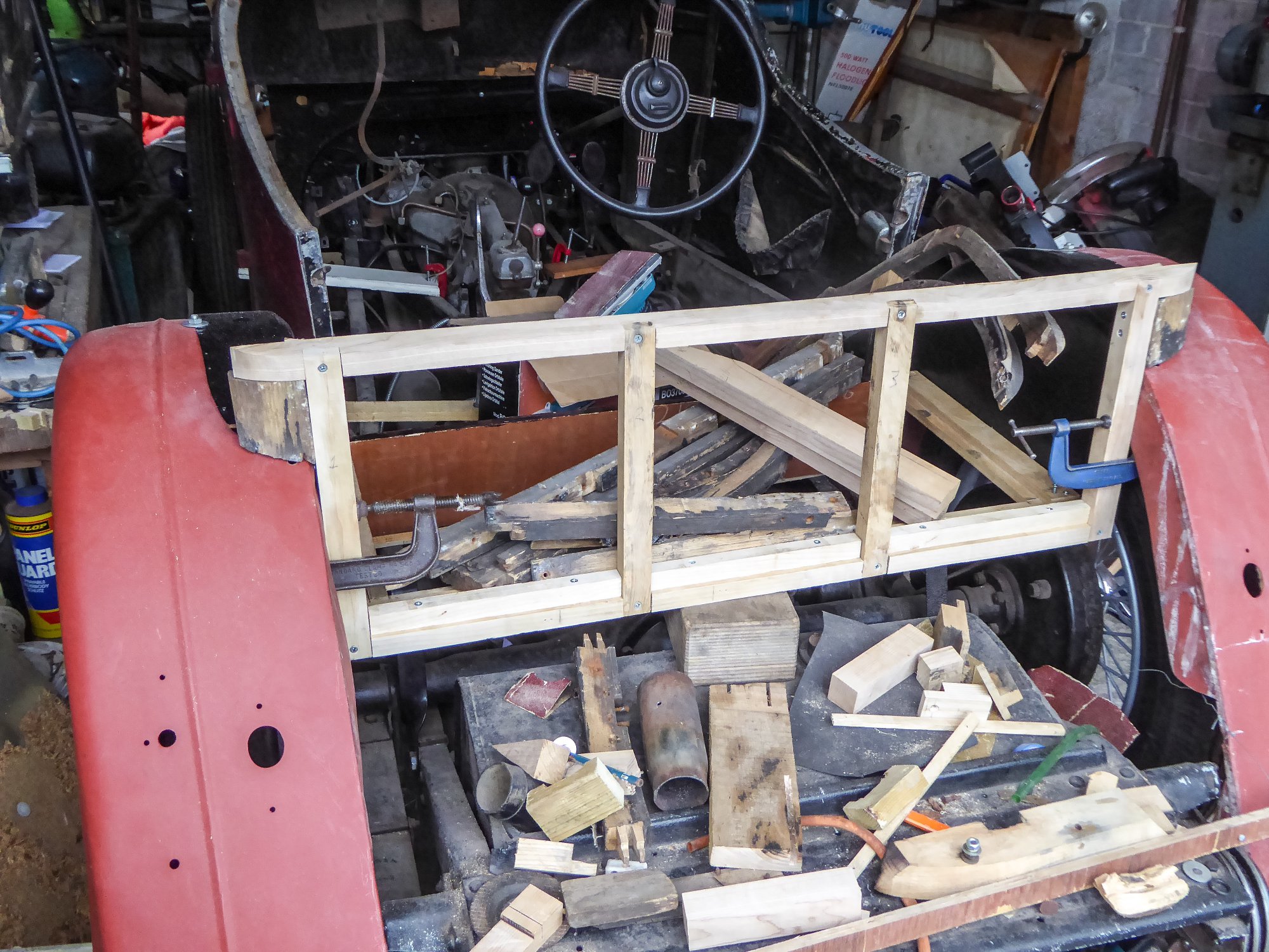

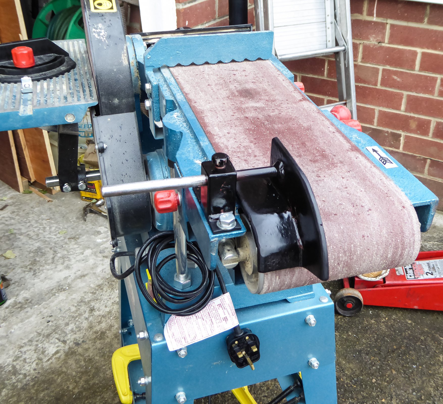

I had already purchased a clarke (MM) combined disc & belt sander to assist in the rebuild. Whilst it is brilliant on sanding flat surfaces & external curves, I found it to be useless for maintaining a square edge while sanding long internal curves.
After pondering the problem for a while I came up with idea of fabricating a square edged guide for the roller end of the belt sander. This has proved to be a great solution to the problem. I now cut the curve on the bandsaw close to the line & then finish off with the guide on the belt sander.
Above are pictures of the fabricated guide fitted on the sander & the rear woodwork on the car, the top rail on the panel appears to the eye almost straight but has a subtle radius on it of approx 110 ft. Fortunately I have the old bodywork to guide me.
