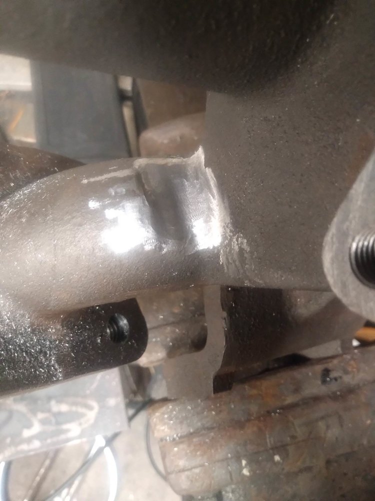

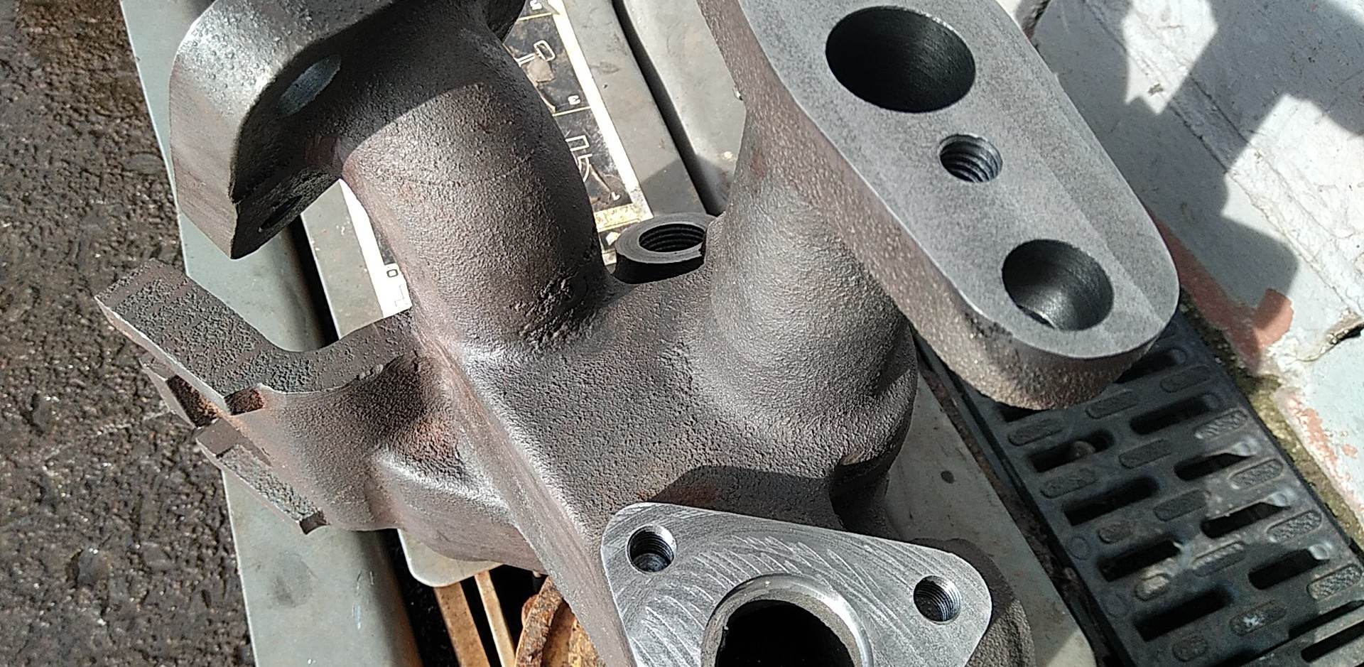

This is a new casting .
The casting is not good at this one point.
It is a Steam Waggon regulator housing .
260 psi superheated steam,

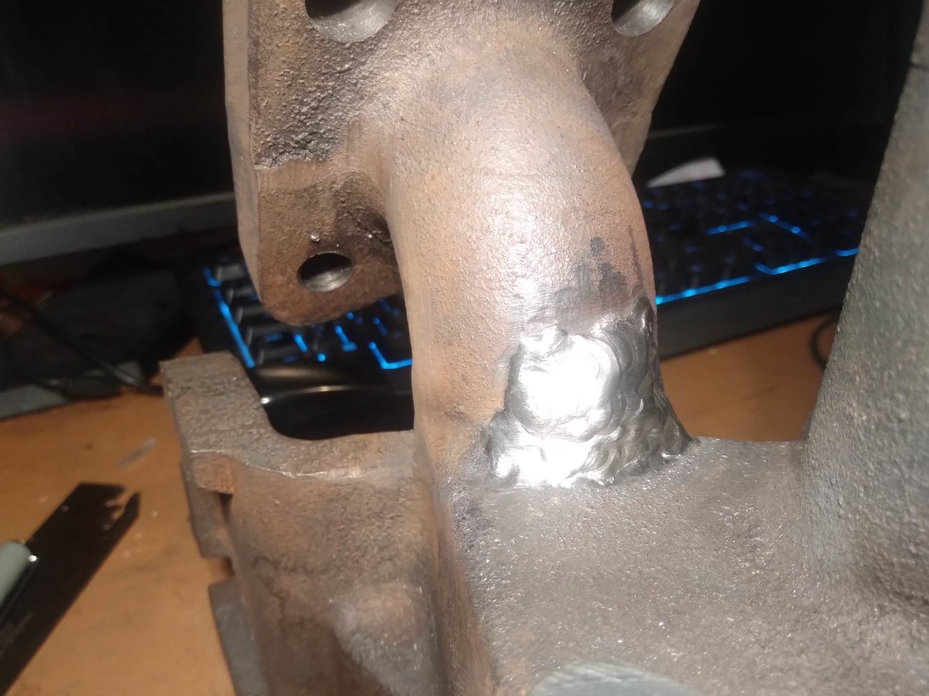

.Welded with Nickel rods (flux removed)
using TIG.
Decent pre heat and very slow cool down .
Will be x ray NDT tested .
