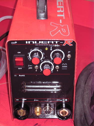

Top left, Amps.
The 2T, 4T switch is explained here. I'll leave mine on 2T till I get more practice
http://www.weldingtipsandtricks.com/tig-inverter-settings-part3.html
The switch on the right controls three different settings for pulsing, constant, fast, slow
A yellow light at the top for when it overheats
The other two knobs are either post flow control or slope in/out, hard to see what they say.
I found this picture/specification
http://www.toolsandwelding.co.uk/products/tig/ltw_tig_swp_tig180.html
The pulse settings are there to reduce the heat and hence distortion. I've not tried mine out yet.
