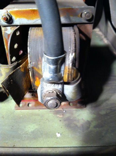

Hi,
I'm new to Mig Welding apart from a traineeship decades ago. I have an old and rugged Union Carbide 160A Welder. The machine has a single dial on the front panel to set the amperage (scaled 30A-180A for CO2, continous, no steps) and an additional adjustment for the wire speed under the "hood" (0-100%). The wire speed and voltage change simultaneously when altering the amperage dial.
Now how do I find the correct wire speed setting?
I tried setting the amperage dial to 80A and tuned the wire speed adjuster so that I get a ws of 4m/min with 0,8mm wire (18% on the ws dial). From there I tried to tune the wire speed adjustment to get a friendly, consistent crackling sound but it is not possible.
I either get a pretty loud low frequency nearly popping sound (just a bit over 4m/min) or a fierce crackling with increasing spatter and no loud popping. The welds look good when choosing the low frequent popping setting range and the arc seems stable, no excessive spatter either and the sound is consistent. Still it does not sound like in the numerous mig welding videos. It is much harder. Lowering the ws way below 4m/min is no option. The loud popping sound persists till the wire speed is too low (burn back / visible drops on the wire).
Is it possible that the harsh popping sound is normal to my machine because of the stepless voltage setting (phase angle control?) or whatever type of choke it uses?
Any hints on how to set up the machine differently to find a correct "default" wire speed setting? Are the 4m/min with 0.8mm wire ok for something around the 80A or am I way off? Got the value from some formula I found somewhere in the www.
Another thing is that the dial is scaled "30-180A CO2". Now what I'm using is an Argon/ 18% Co2 mix. So what does that mean for the scaling? Do I need to choose a lower amperage on the "Co2 dial" to get the same amperare on mixed gas?
I know... lot's of questions and text. I'm sorry. I've consumed every source I've found regarding mig welding stuff but I still don't have the feeling that the ws/voltage are in the correct correlation. The crackling is so rough. No bacon and eggs...
Cheers,
Ruben
PS: The torch and ground cable are new (including a new ground socket and wiring inside the machine). Fresh grounded, shiny scrap metal (2mm) for the tests. New expensive ground clamp with massive copper jaws. So most likely no problem with a bad ground. Even tried a different clamp and cable from the Tig welder.
