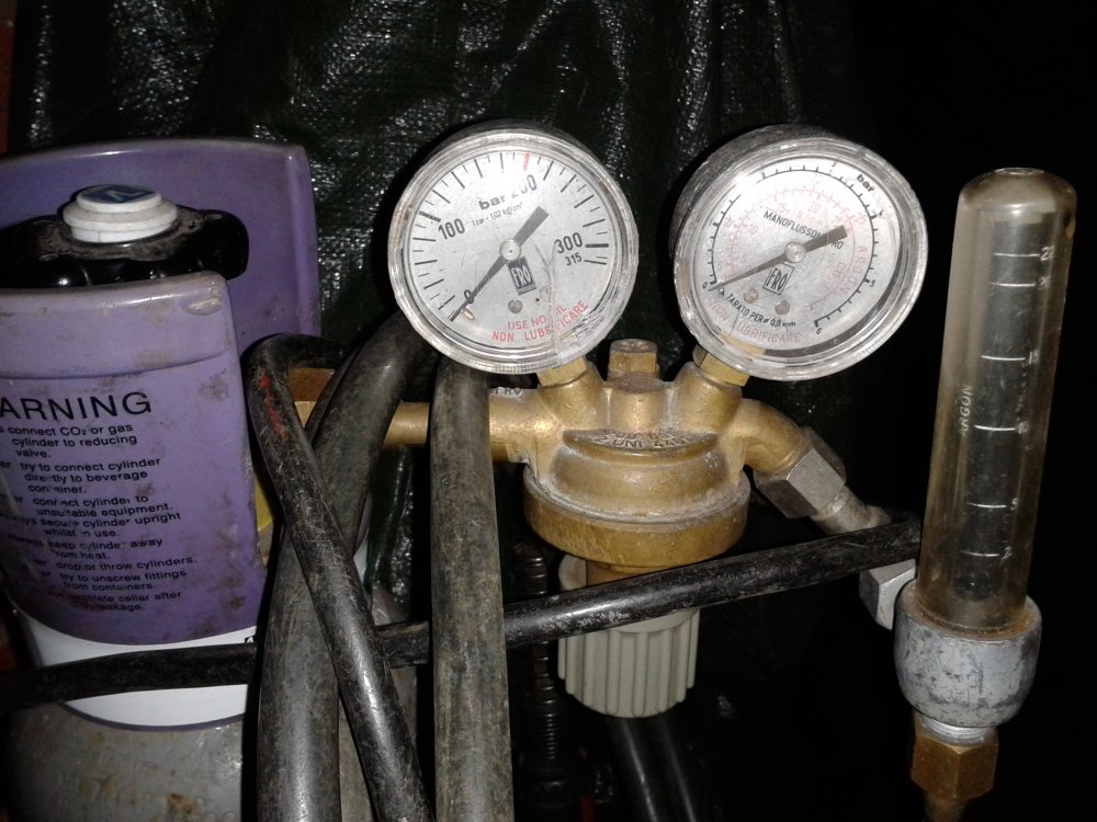

Just looking for some advice to see where I am going wrong. I'm trying to set up my co2 with my sealey mig welder. I've fitted a brand new parweld co2 regulator and its wound right out anti clockwise. The problem is when I open the bottle as slow as possible the pressure just runs up straight into the red and the gas leaks out the torch. What am I doing wrong ?
