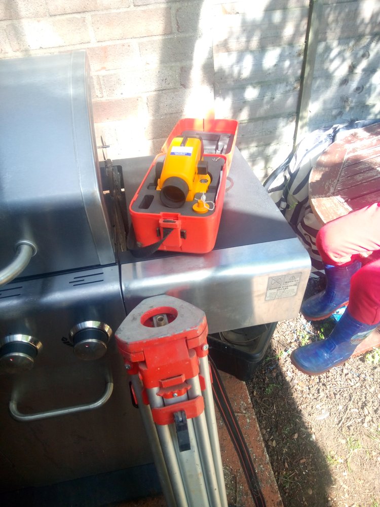

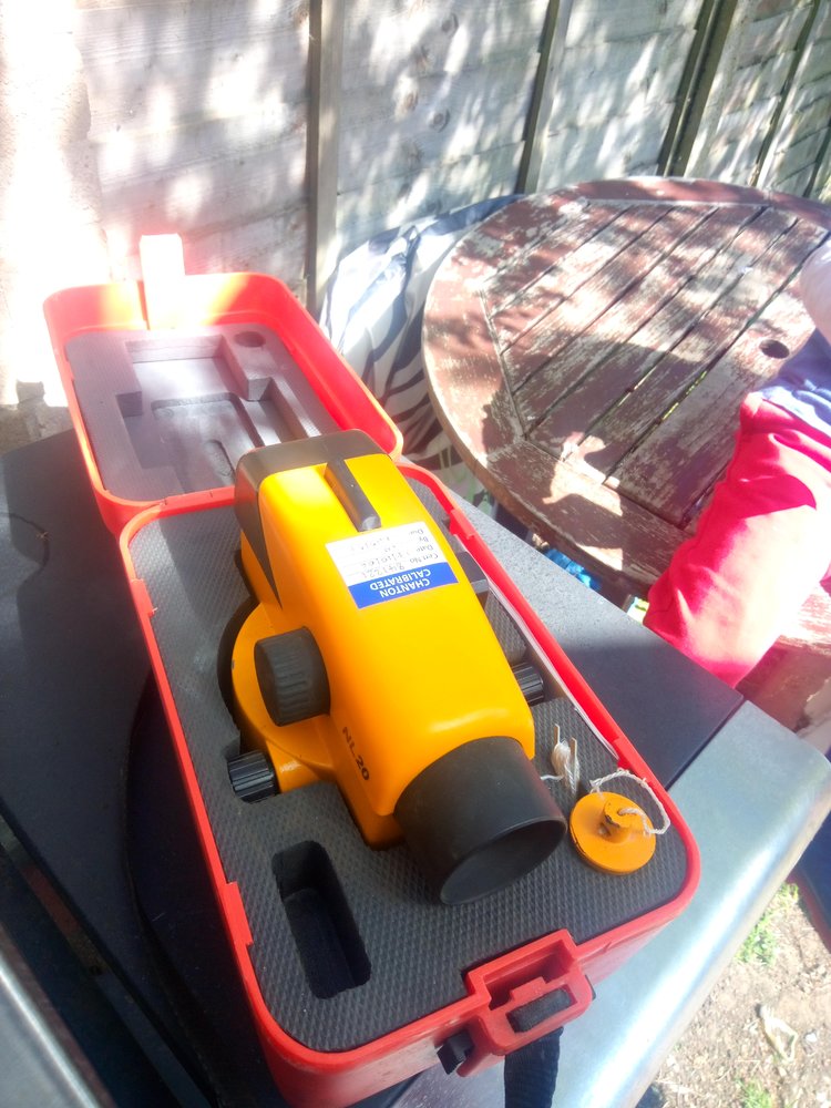

Well done.25 quid. Gotta pop back for the gauge next week. It's at her son's
View attachment 286686 View attachment 286687
You can self check these I'll dig out the guide

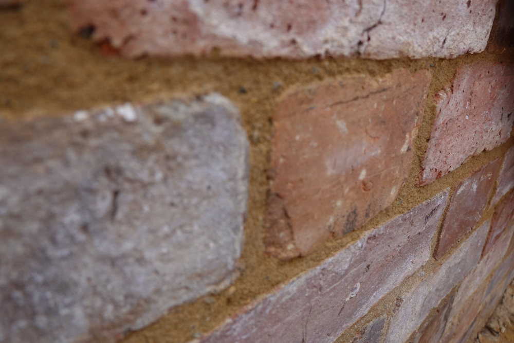

Sun during the day and frost at night is a pain for lime mortar. But I'm getting a good tan.
Very old pub iircWhy are you using lime mortar rather than sand and cement. Is it to blend in with previous brickwork?
The bricks are 200 years old and badly made - they are very prone to spalling. The lime is much better than cement at letting excess water evaporate. I think it looks nice too. I've repointed the whole house in the same mix so it should blend well too.Why are you using lime mortar rather than sand and cement. Is it to blend in with previous brickwork?

With lime its essential to use sharp straight builders sand doesn't work due to how the lime bonds to the aggregateI'm doing something similar to match what was on the house. 50:50 sharp sand and builders sand mix (and 2.5 sand to 1 NHL3.5). Flush pointed, then a couple of hours later when it drys a bit hit with a masonry cleaning brush then brushed lightly. It recesses the pointing very slightly, exposes the edges of the bricks, and because I'm using sharp sand it reveals a bit of the aggregate. I think the finish looks neater than a trowel finish.

The builders merchant sharp sand isn't ideal by itself. It doesn't flow. (At least the stuff available here. I started off with some really bad plastering sharp sand that was magic, but they stopped selling as I was the only person that used it.) You do need to experiment to get the lime mix right. 3:1 is often quoted but I found that hit and miss and ended up increasing the lime content a bit.
The check is called a Two Peg Test. In a nutshell, it is this:Well done.
Have two points around 50m apart on fairly level ground. You can use two pegs or, corners of inspection covers or stop valves. Anything you'll be able to identify easily; even crayon marks are fine. Call one Point A and the other Point B.
Set the level up as close to halfway between the two point as you can and level it up. Check the bubble at this point by levelling as well as you can and the turn the instrument 180 degrees. Bubble shouldn't drift off.
Now place the staff on Point A, take a reading and write it down.
Move the staff to Point B, take a reading and write it down.
Take one reading from the other to give you a height difference between A and B.
Pick the level up and move it towards Point A. Set it up again around 5m from it.
Put the staff on Point A and take a reading. Write it down.
Move the staff to Point B and take a reading. Write it down.
Take one reading from the other to give you another height difference.
They should be within say 4-5mm of each other. This test checks that the line of sight is actually perpendicular to the vertical plane. Any error measured on the short distance is magnified over the longer distance.
First thing I would do is set it up and level it. Now look at a wall or something and, whilst you're looking through the telescope at the wall, tweak one of the footscrews slightly. The cross hairs should jump off the point you were looking at on the wall but then return to it. If it doesn't do this, it could mean the compensator is damaged.
