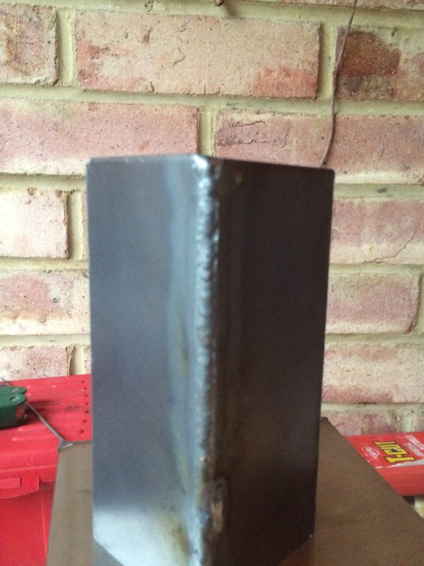

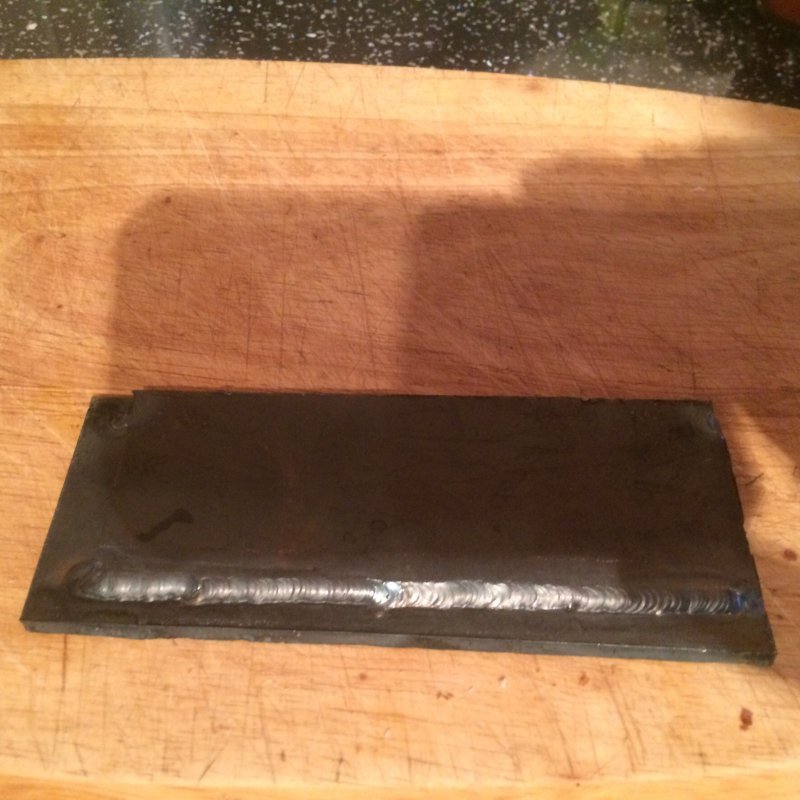

What am I doing wrong? Gas shield? Too hot? Arc length? Moving to slow?.
are you cleaning the metal ? get a sanding disc and get the mill scale off , so you want bright shiney metal to start with no grease or oily substances , what amps are you running at , what gas flow are you set at , what flavour tungsten , let us know and we can give you a good idea what to try next
I didn't clean the metal I cut it with a plasma cutter 90amps on 3mm mild,Thoriated Tungsten 2.4, an Albee gas bottel on number 8.
Back ground amps 50 main amps 90?
