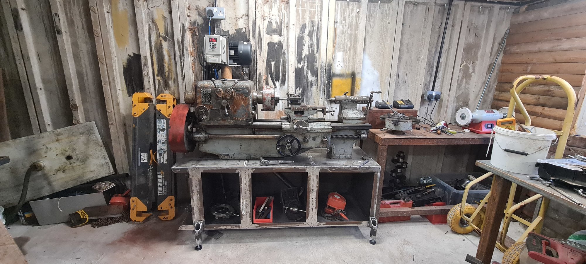

Got this lathe a while back and just made the cabinet for it, this week i will be sorting a tray for it and then going to level it up properly. How accurate does it need to be, its only a small lathe as seen ( 1.5m long ) and solid cast build.
I have leveled it for now with a 1m spirit level. I see folk get machinists levels. IS that needed on such a small solid built lathe or will a good sprit level do, as in builders type ?
