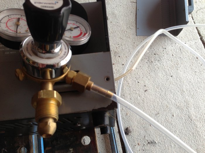

Screw reg on bottle and tighten firmly but not real hard.
Connect gas line from MIG (you did get the adapter?)
Open bottle valve slowly.
Adjust black knob until the flow gauge reads 10LPM or 20SCFM.
That's all, but check output gauge as the setting may "settle" in a bit.
