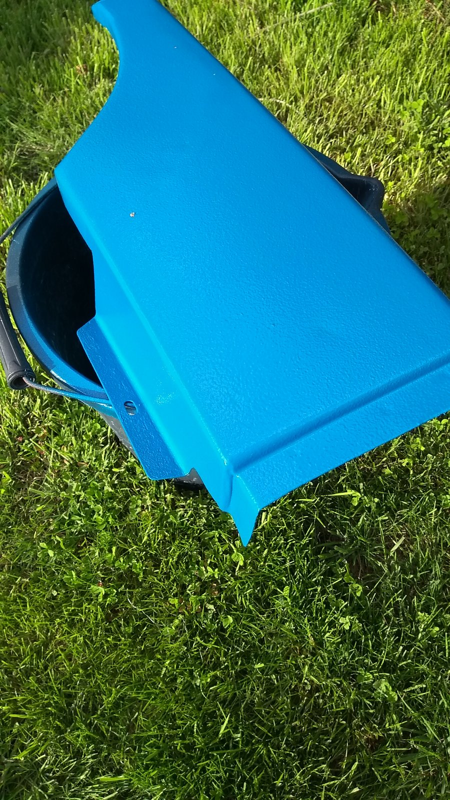

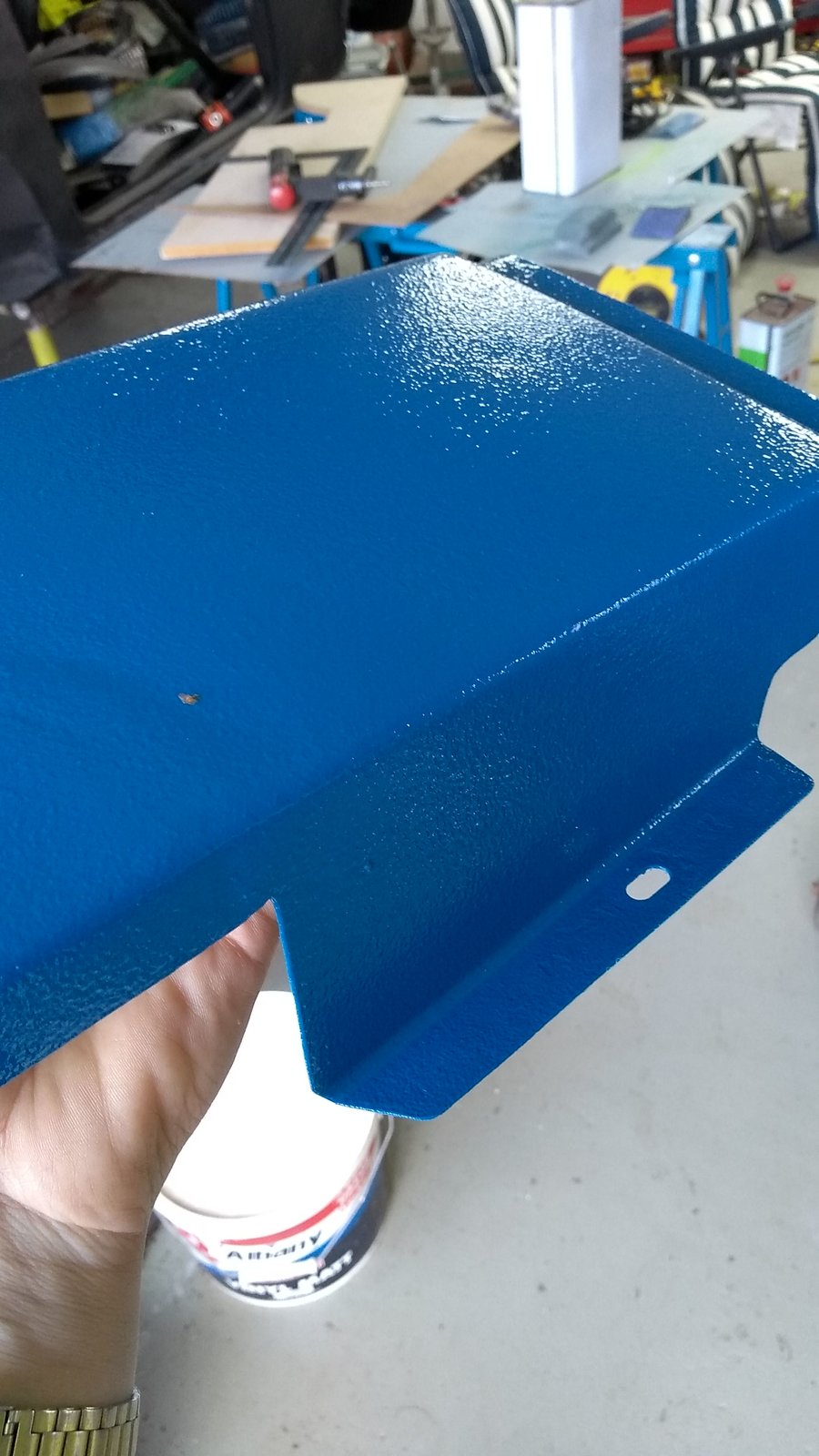

I tinted this raptor with some cheap 2k solid from Jawel, 2 coats wet-on-wet with my baby Volum-air hvlp turbine, couple of coats of rattle can clear over the top...
Very pleased... Done a deal on a more industrial turbine system with a full set of tips/caps/needles going up to 3mm
should be faster at hammering the raptor on.
Remember your ppe folks, the iso gave me a really runny nose for about 24hrs post spraying, silly me.
