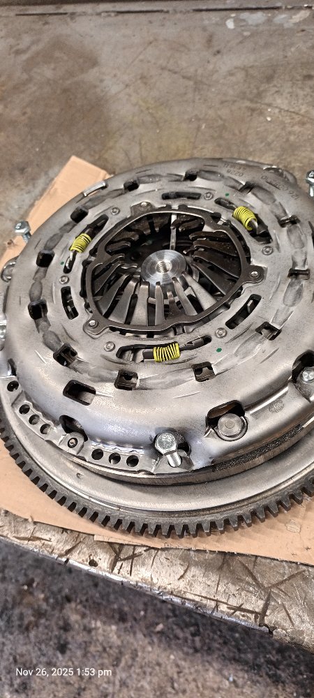

whats that out of , not seen that set up before

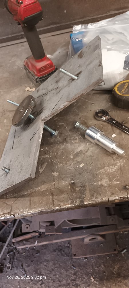

Is it absolutely vital to use the correct tool to mount a self adjusting clutch cover plate?
Can i just do up the cover plate bolts to pull it up, or is that likely to damage the adjusting bit?
Thanks for any info.
interesting ,,, Ive never done a clutch on a disco 3 ,,,, there you go very rare we saw a manual ...It's for a Discovery 3. In the pic it's sitting on a new DMF.
My Disco 3 is a manual, good luck bleeding it... I had to reverse bleed it after trying all sorts it was the only way to get a pedal. As others have said with new bits you're good to go just tighten up evenly.
Wow that's another complication vehicles really don't need!![]()
