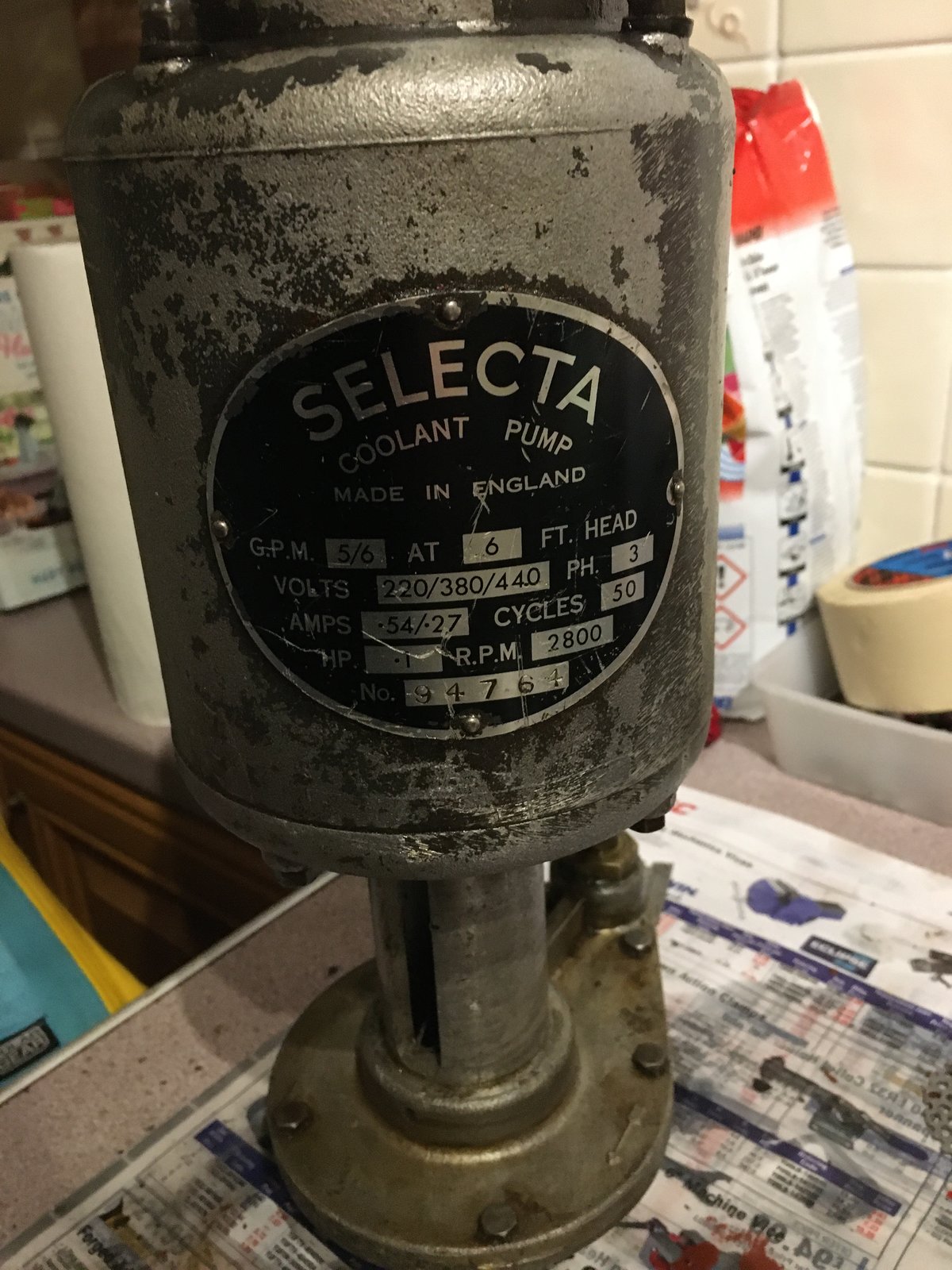

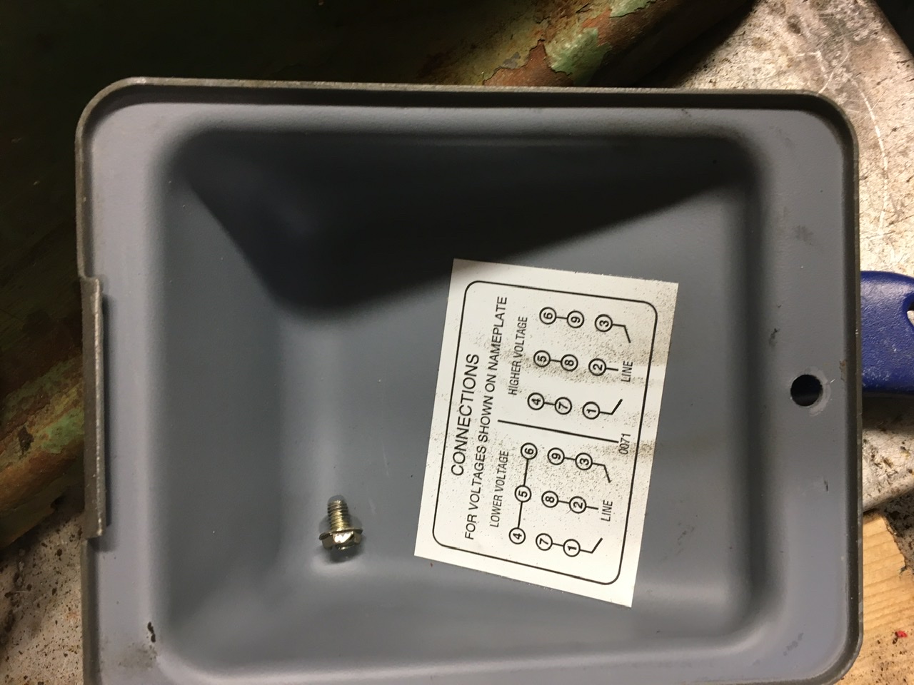

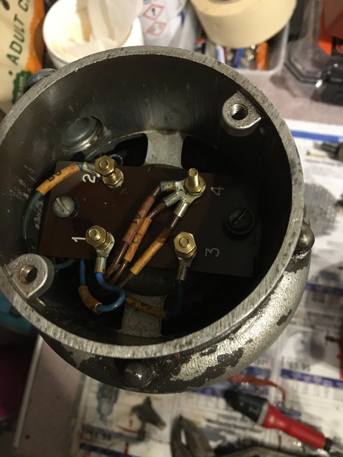

I assume the 3 connections currently combined together at the star point will be split out and connected to the incoming 3 phases for 240v operation, so connecting in delta? I’m 99.9% sure that’s correct but if anyone’s got a wiring diagram or has one already running from 240v it would be good to confirm
